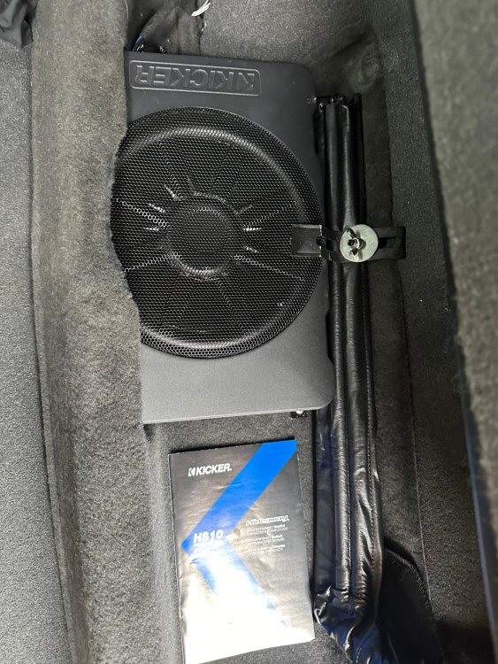

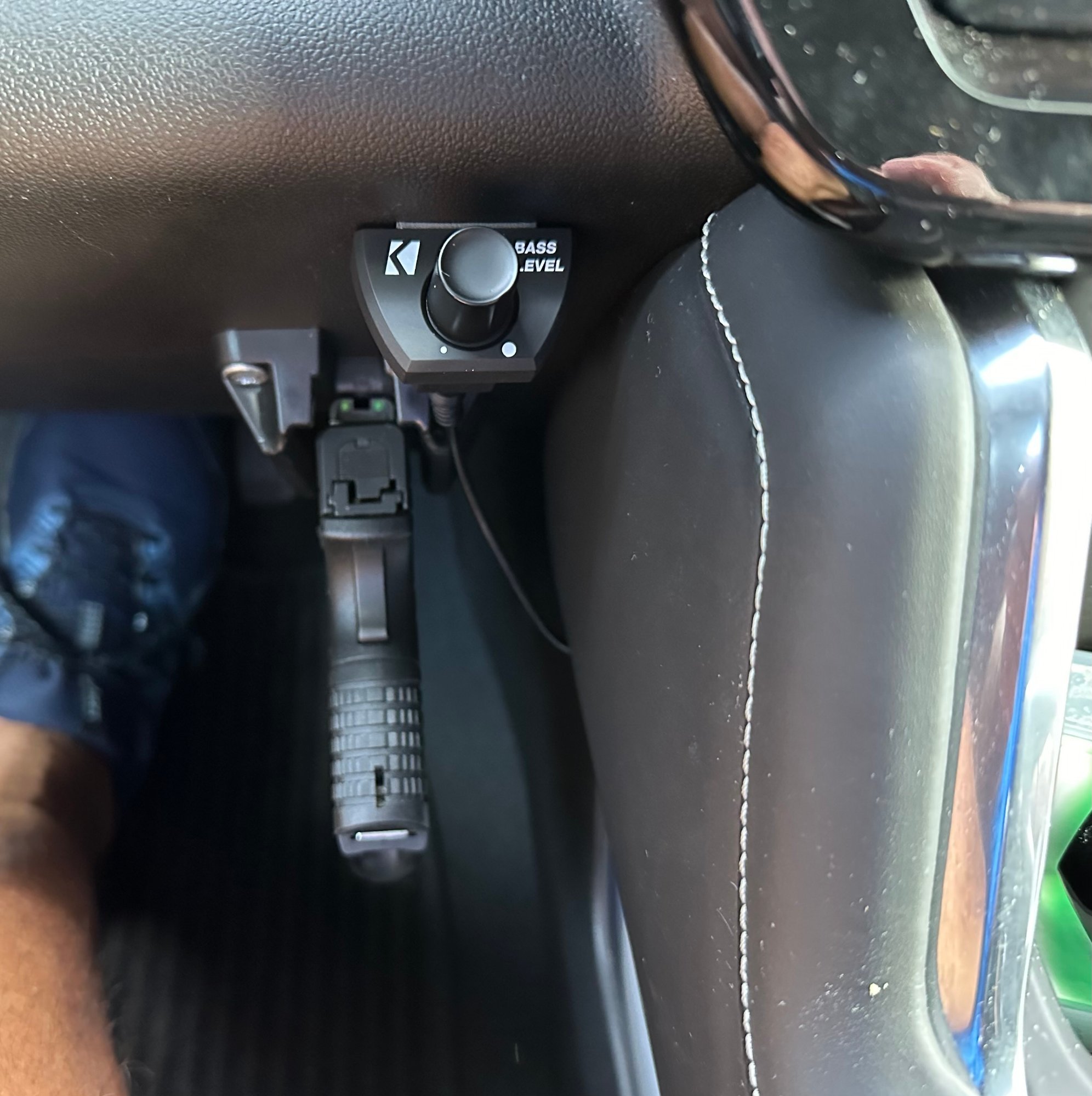

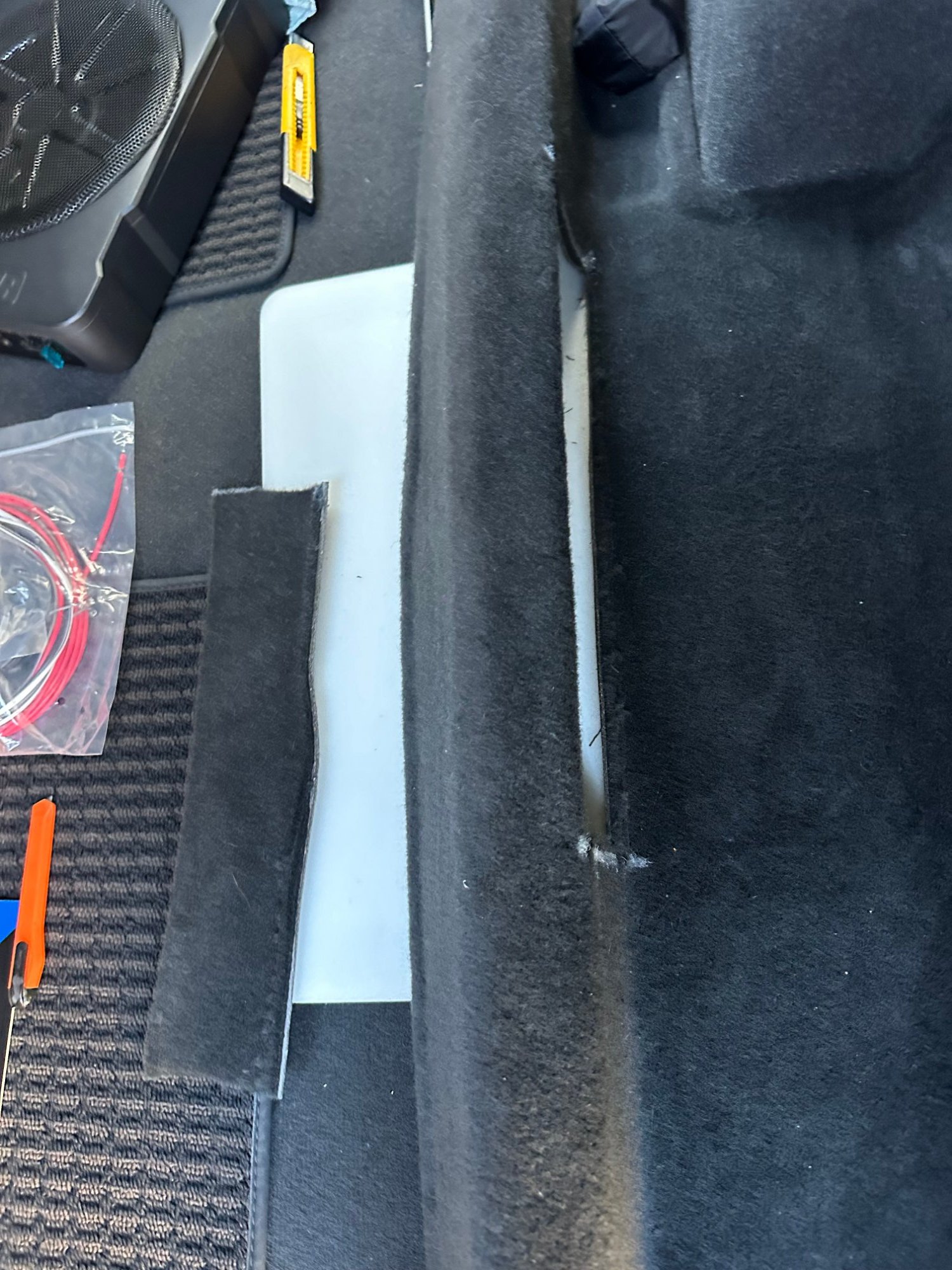

I got my Kicker hideaway 46SH10 installed.  Turned out nice.  Found it to fit PERFECTLY within the storage area under the rear seat with just a little trimming of the storage area wall.  It's exactly what I was looking for.  Small size with decent sound and easy installation at a good price.  It's not going to pound your chest when the base hits but it does a good job of filling in the low end on the new refreshed Bose system.  I mounted the base boost control under the dash just in front of the driver's knee (just above the .45) both for easy access.

I put a Kicker 46HS10 Hideaway under my rear seat and I love it.  Really fills in the bass that was missing from the factory Bose system without rattling the windows....lol
