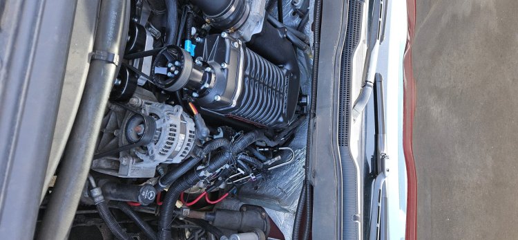

A while back i posted about my venture on adding a blower to my 2015 high country 6.0 with 4:88 and pedal commander. Did a whipple blower with intercooler, 1000 cc injectors, ngk plugs, msd wires, walbro 540 pump on e85.   Truck didnt fit on the dyno so he street tuned it with the wide band.  He said the truck is a beast.  He said it makes a ton of low end torque.  I pick her up tomorrow and put her to work and see how much of a difference.  He said that this truck has no ethenol sensor it has a virtual setting that adjusts off of the af sensors and o2 sensors.  Which is good cause he said i will have no issue running e85 or 93.  He said i made a easy 150 hp n tq over stock. Whipple was 4900 Injectors 700 Walbro was 75 Wires 100 Plugs 80 Install n tune 3000 So about 9k into it which was about my budget

Here is my update on the 15 6.0 with a whipple.  Went back to tuner today for the issues i was having.  Pedal commander and whipple no good.  Had to get rid of pedal commander.  Changed a couple of mph shift points and driving a lot better.  But do miss the pedal commander.  Trucks virtual e85 is garbage.  Installed dsx e85 kit and went from 50% to 72% ethenol.   Gas up tonight and put her to more work and see what happens.
  Looking for insight.  2015 6.0 just did a whipple.  Only does it when giving more than 50% throttle.   Having issues and trying to figure it out.  Heading back to tuner for 3rd time next week.  Sent him this from another group  Dirk Diggla doesn't look to be a convertor issue, especially if Temps are still normal. Every convertor failure I've seen,, the 1st warning signs are 6th gear shudder and higher than normal temls from slippage,    id be intersted in seeing what was done to the VTT tables and reported torque tables in your tune. These gen 5  E78 pcms are 100% torque based and if those 2 tables aren't done correctly cause lots of issues. I'm betting your tune is way off  His reply Hey Andrew, I’m m not sure what that noise could mean, I read what you sent that you found online, but the VVT tables are stock and untouched, the TW tables were raised in the correct areas, I was able see the video I’m not sure what that noise is..   Looking for insight.  Know its hard without a log file to view.  https://drive.google.com/file/d/1LU5kRrMpe3SMn9BuDwLNnwUyqM3NDdys/view?usp=drivesdk
