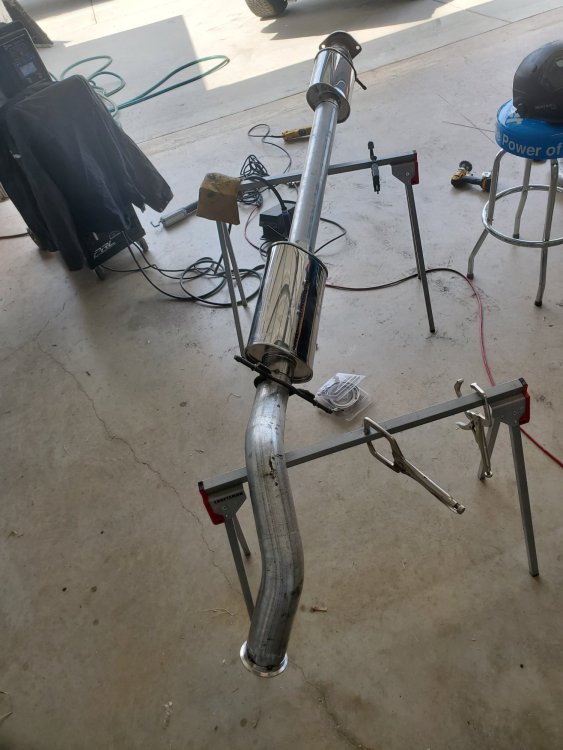

yes its 3.5 in i used the borla xr1 summit p/n bor-40086 3.5in in/out and summit p/n sum-640274 3.5in and 45in long stainless pipe to make up the space left over. and it sounds great not super loud but very nice tone and no drone in the cab (mines a reg cab). and i suggest welding it in honestly a local shop will not charge much for that, its just much cleaner to do it that way.
awesome thank you! Do you need the extra pipe based on the size difference of the muffler? The borla that much smaller?
