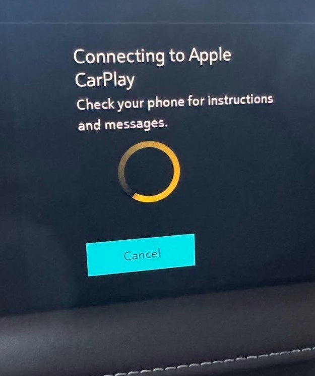

I’ve owned my ‘24 Sierra 2500hd since July ‘23. No issues with CarPlay until a few weeks ago when I went through about 45 minutes of OnStar reps trying to help me out. We pretty much deleted and started from scratch on both the truck and my iPhone 15. With my phone I had to go into settings a few times and confirm stuff was toggled on or off. In the truck, they pretty much had everything deleted and start me as a new owner.
A work ticket was submitted because their steps didn’t fix the problem. A few days ago, I get a voicemail answering the work ticket instructing me to take it to the dealer for further troubleshooting. Sure, when I get time off from work I’ll have to spend half a day down there letting them break something else (long story). So bottom line, my car play still doesn’t t work.
I’m sure somebody out there has the fix. Please chime in.
