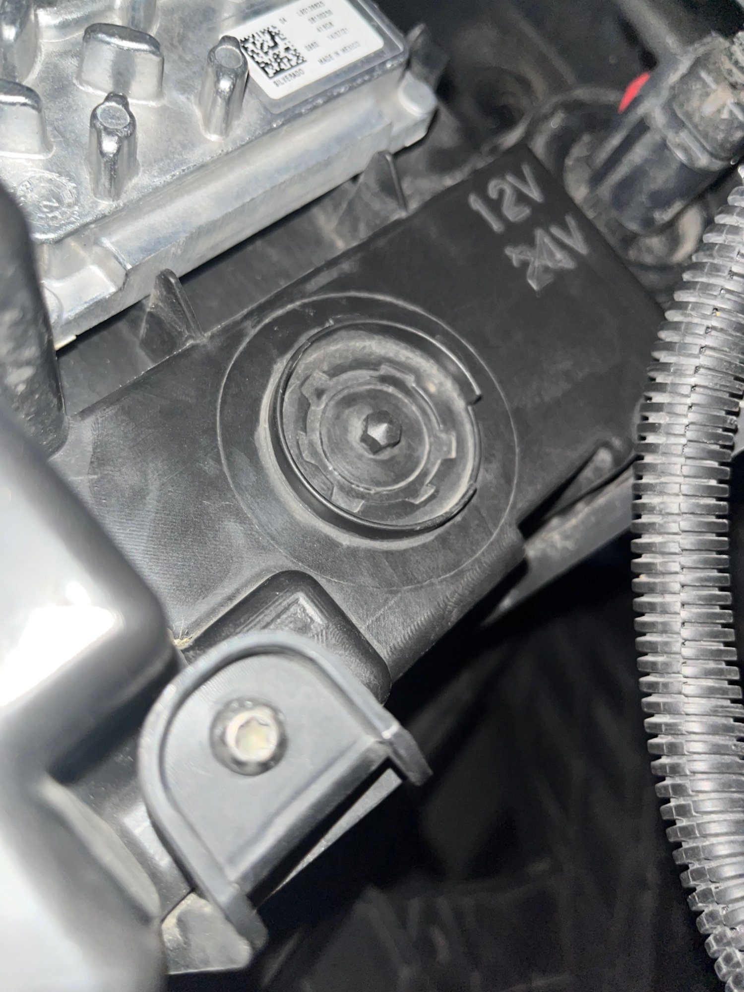

2021 Chevy Silverado High Country Front Turn Signal LED Stopped Working
It's integrated into the headlight. A good headlight retrofit company can probably open the headlight and replace the diode, even customize it if you want.
I've used this company in the past. Pretty reputable shop in the headlight retrofit world.
https://lightwerkz.net/
On 8/17/2023 at 8:17 PM, J-Chevy said:
Does anyone know how to replace the LED turn signal on a 2021 1500 Silverado High Country?  It doesn’t have the same turn out bulb as most other Silverado’s.  IMG_7649.thumb.jpeg.b82702d45dc8d4a8e9ce02699c0933cc.jpeg
Did you get resolution for your problem? What was the fix?
Needs a headlamp assembly.  No parts can be replaced on the full LED.  No bulbs either.
