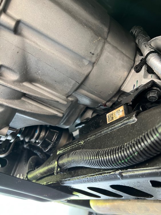

Brand new 23 1500 Z71 currently at the dealer with a grinding transfer case while on vacation. Truck is just under 4000 miles and dealer is saying it barely had any fluid and won’t be covered for lack of maintenance. I asked where it says in the manual I’m supposed to stop every 50 miles and check fluid levels in a new truck and the service writer got smart with me. I saw fluid covering the underside of the truck when we stopped to check the noise but there was no way I was going to spend the night at a gas station in BFE with my family and continued on to the hotel since it was so late. The actual leak looks to be coming from where the case mounts to the transmission at that gasket.
Will any 2 speed transfer case from 2019 and newer fit or does it specifically have to be fit a 10 speed transmission? If I can find one a local mechanic said he can get it replaced in two days. What a HUGE POS!!!!!

The transfer case was in 2H. It’s grinding because there’s “a capful” of fluid and metal in it from all leaking out. The original dealer that gave me the BS was able to get a tech to look at it first thing before telling me checking fluid is part of maintenance but again the truck is new. I can understand checking the engine oil but transfer case fluid is nonsense.
I did not think to originally call GM. It’s getting moved to another dealer here in Orlando this afternoon but they are making no promises to get to it before next week. The picture shown is where the fluid is leaking from. Right where it mounts to the transmission.

You either have a transmission output shaft seal leaking, or a transfer case input shaft seal leaking.  Both are relatively easy fixes and can be done in a single day.
I had a leak from the same area and fixed it myself, something you DEFINITELY should NOT have to do considering your mileage.   Here is a link to the repair:
Grinding T case is junk from fluid loss. It's a matter of getting one in from GM, hopefully not on backorder.
