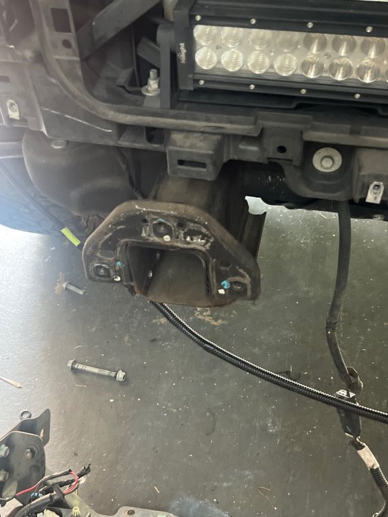

I bought this truck over a year ago and let the excitement get over me and now I finally decided to dig into another sore eye of the truck because I noticed the tow hook was bent downwards and my bumper alignment is completely off. Point being I took the bumper off all the way till I got to the point where there’s a bracket welded onto the frame. From what I can tell, fingers crossed. It seems to be that just the bracket is bent. I am wondering if taking it to a shop
to get a new one welded on would have any problems with the clean title or anything. Should I bring this up with the dealer I bought it from as it wasn’t disclosed? Thanks
I attatched the only photo I took, I know should’ve taken more but I wasn’t thinking at the time. But the top and right side of that bracket is bent inwards

Floor jack and a block of wood might bend it back up.
