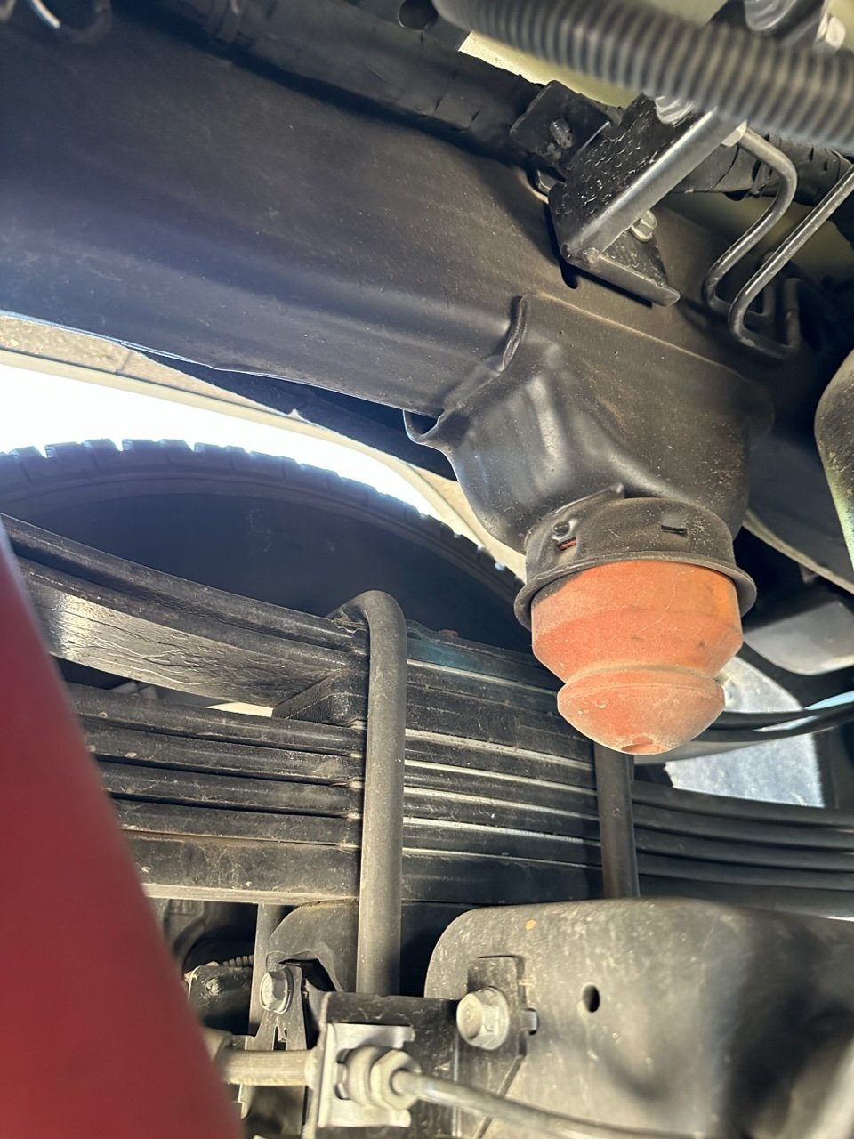

Here are some photos of my spring pack. I’m not sure exactly what you wanted to see. It’s marked 84992006.  Five primary leaves and two overload leaves. With 1700 lbs of camper weight on the rear axle I’m about 1.5 inches away from engaging the overloads and a little over 3 inches from first hitting the frame bumpers.  I hear the overloads contact the frame fairly often going over speedbumps and such, but have never been aware of hitting the frame bumpers with the camper on. I’ve never loaded the truck to max payload so I don’t know how low it gets at 4000 lbs in the bed.

Thanks! Didn't mean for you to crawl under the truck! So you're 2500 has overload springs?
im headed to the local dealer with this info. Change the springs and add overload bumpers.

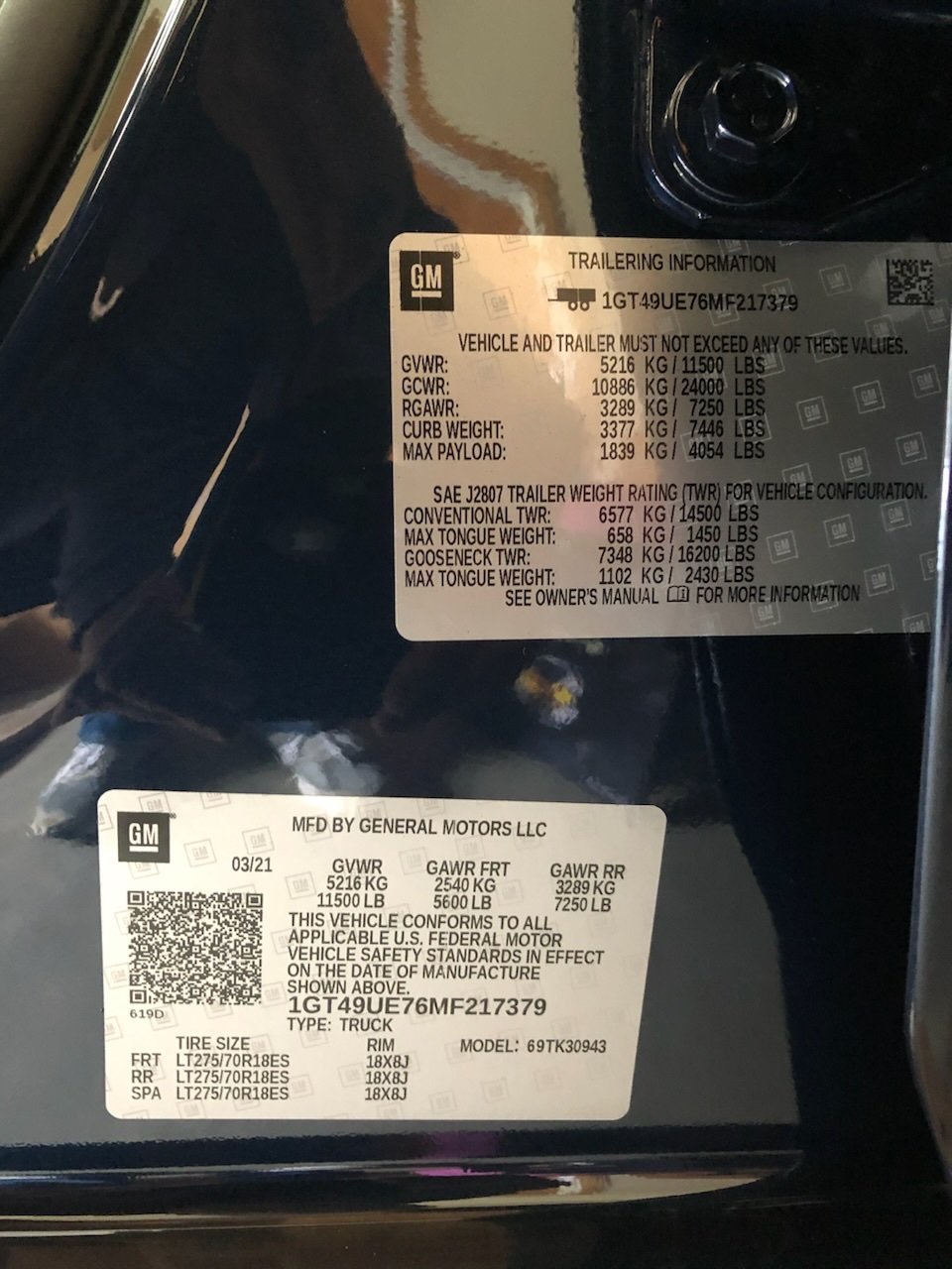

So you're rear axle is only good for 650 more than mine.

I thought I had identified my truck earlier. It is a 3500 hd cclb srw gas slt. The rear GAWR is 7250.

It’s pretty easy to find the GVWR and GCWR for the different configurations in the available spec charts. The curb weight you end up with, and hence exact payload, is not provided. Probably the easiest way to get an idea is either find  a truck at a dealer and look at its rating or come on here and ask if someone has a similar truck.

actually I did notice in your previous post it is a 3500, I'm assuming I can order the stops for the overload springs, see what length bolts are recomended and find if the overloads are sold seperate from the assembly I already have. When the seller delivered my camper his 2500 wasn't squatted in the back, he has [jounce?] bumpers. I didn't remember to look under and see if
they were making contact.
the 84992005,6,7,8 i'm guessing are left and right of two different weight ratings. I'll crawl under my truck and check the numbers and see if they match side to side.

The parts catalog shows all four part numbers as right springs with different associated suspension option codes. It doesn’t list any left springs at all.  Both of my springs are marked with the 84992006 part number. So you order the same part number for left and right apparently.
