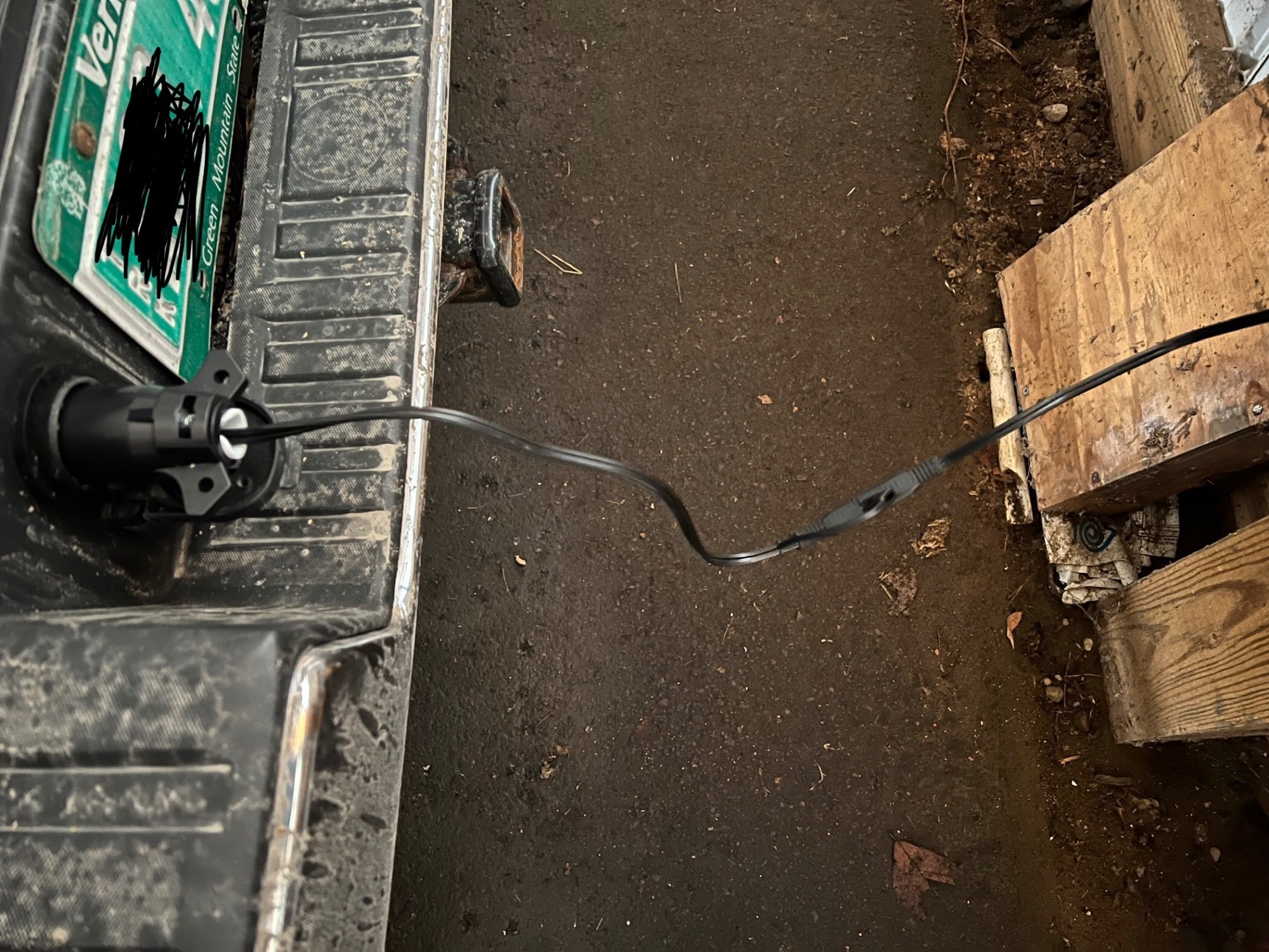

I know it’s an older post but put together a 7 way trailer plug for charging. I have two Battery Tender Jr’s and one Battery Tender Plus. I only ever use two of them at a time and used the ring lug connections.
I took one of the three alligator clamps that I wasn’t using and cut it below the fuse holder. Used a Hopkins 7 way trailer plug from WW. Put it together and works good with my 2018 1500 with 2 of the maintainers. Don’t have a pic but looks like the one gemarsh posted.
Will work on getting a 12v outlet in the cab whenever my AT4 HD arrives.
Edit: Added pics.

Update: The 7 way trailer plug that I put together to charge my battery was for my 2018 1500, the trailer plug 12v was connected to the main battery, did not have an aux battery. I found out after getting my 2024 AT4HD, the 12v at the trailer plugs are connected to the aux battery. Won't work anyways!
