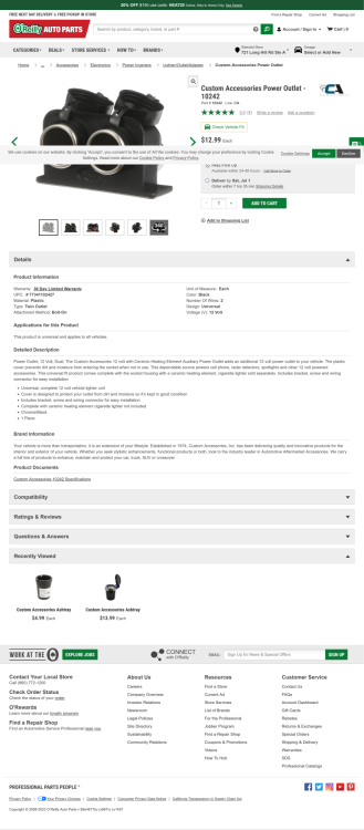

FYI JUST GOT A TWO POST 12v.  CIGAR LIGHTER RECPT. FROM O'REILLYS, TO MOUNT INSIDE MY '24 HD ARM REST CONSOLE BOX, WHEN TRUCK ARRIVES.

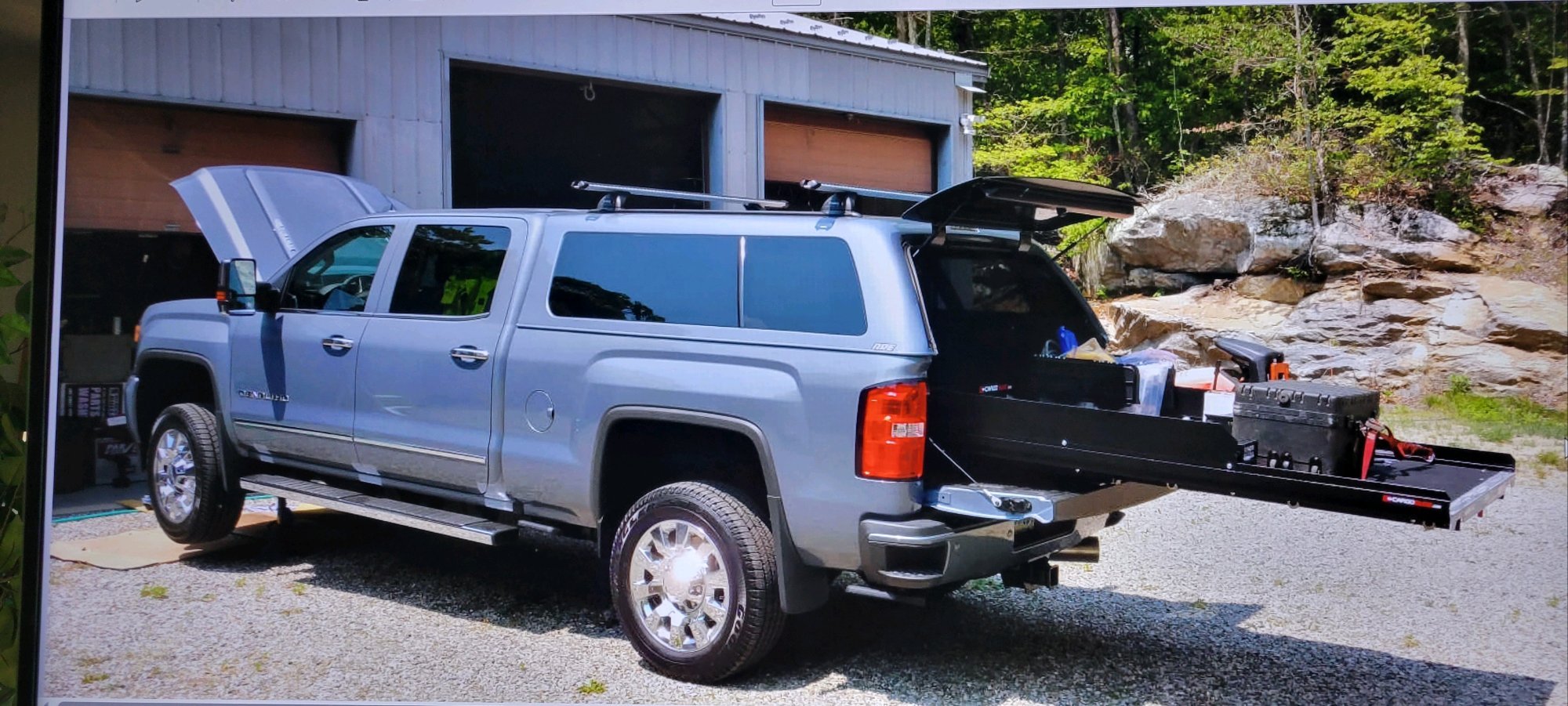

Suggestion for bed access for tools etc. Attaching a pic of my '16 HD , with a "Cargo Glide" slide out. Got  this for my bad knees, to not crawl into the bed for tools etc. 2016 GMC 2500-HD PULASKI AT SHOP OIL CHANGE.pdf2016 GMC 2500-HD PULASKI AT SHOP OIL CHANGE.pdfSeveral different brands out there, and also ones with weather-tite compartments, for those with no cap or tonneau . PDF pic for the slide out is named '16 oil change at shop.
Here is a better pic of the Bed Slide out I got in '16. Transfer to my '24 very soon.  These come in Aluminum or steel. Full or partial extension, and weight capacity. This one steel, full extension, and 2500 lb. capacity.

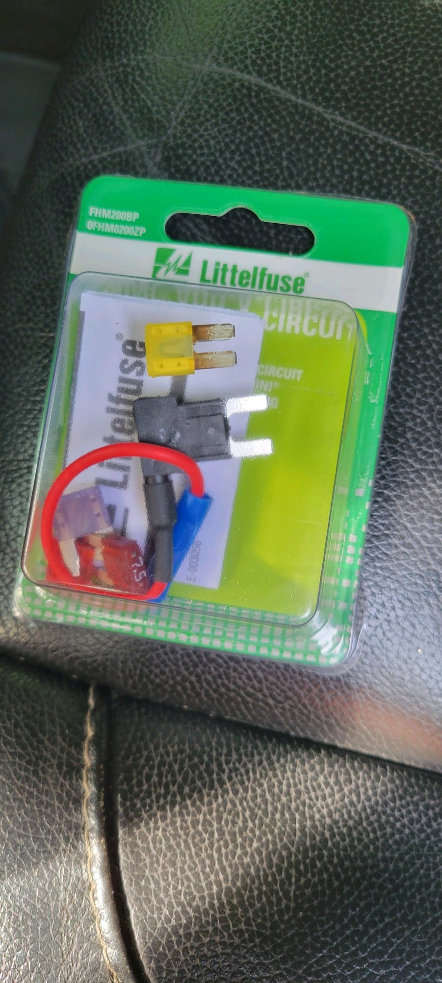

Adding 12v. in the Cab,  fairly  easy, Fuse "Add-A-Circuits",  from "Littllefuse" and Bussmann".  Napa should have these as well. Most of these fuses in the left & right Dash are the "Micro" not "Mini" size.
