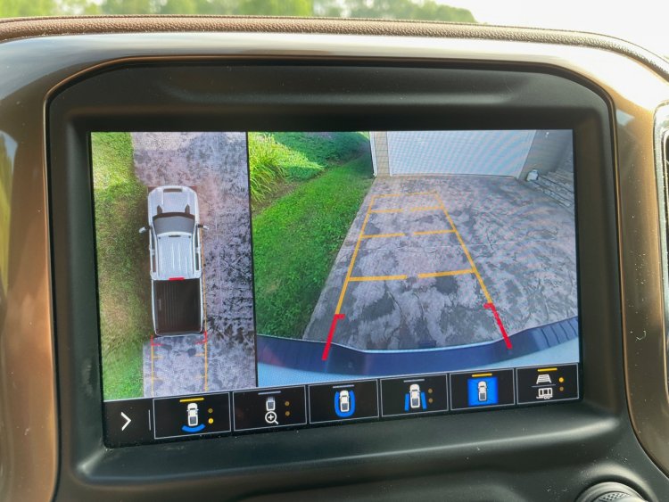

So, what do you know about using software tools to calibrate the SIDE cameras on the truck (2022 Silverado 2500HD) so that the front, side and rear cameras all show lines that run along the side of the truck (like in a parking lot or the curb at the side of the street) that actually line up with each other?  There should not be a big gap when a line switches from a front camera to a side camera.

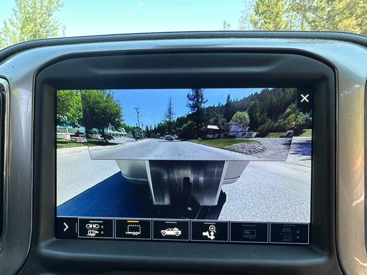

Hello,
I have a 2024 HD 2500. I want to confirm the height corrected the transparency camra issue. I recently installed my camera but it would not calibrate. The preview button remained gray and the transparancy selection remained gray the entire time. Showed it was calibrating, but after multiple time driving 25 mph stright fornmiles no luck and no progress bar was found. I have the stacking, and it shows the turning and rear views, but no transparency view.

Tried the above possible solutions. Cannot get highlighted transparent trailer key activated. Calling GM/Chevy to see if there are anymore workarounds. We have a 2024 1500 Sliverado LTZ with a 20 foot box travel trailer.
