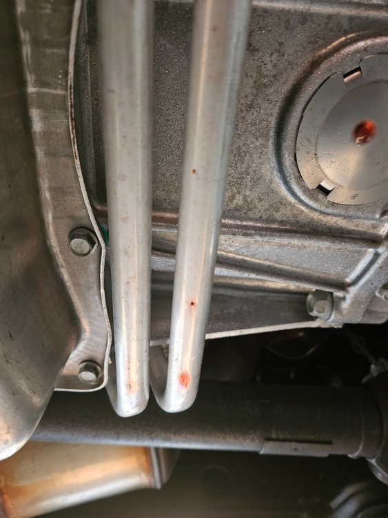

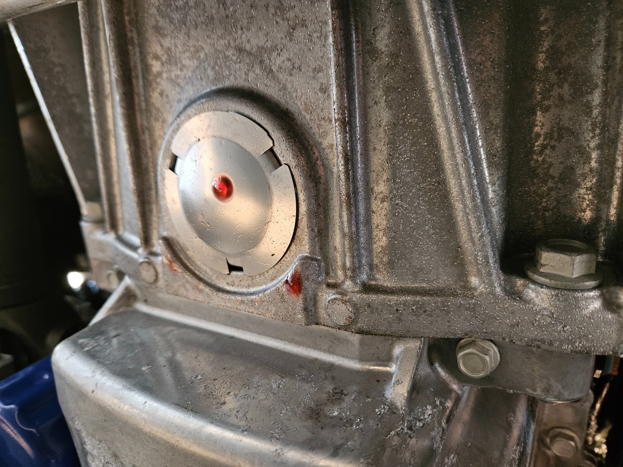

Sorry to see other members are experiencing the same drip from the transmission that I did.  I have 400 miles or so since my transmission replacement and so far I don't see any leaks. Keeping my fingers crossed.

Just looked under my 2024 gasser at 1000 miles.
Sorry to hear you are going thru this as well.  I am here in CT as well and ONeils in Avon has been taking care of me.

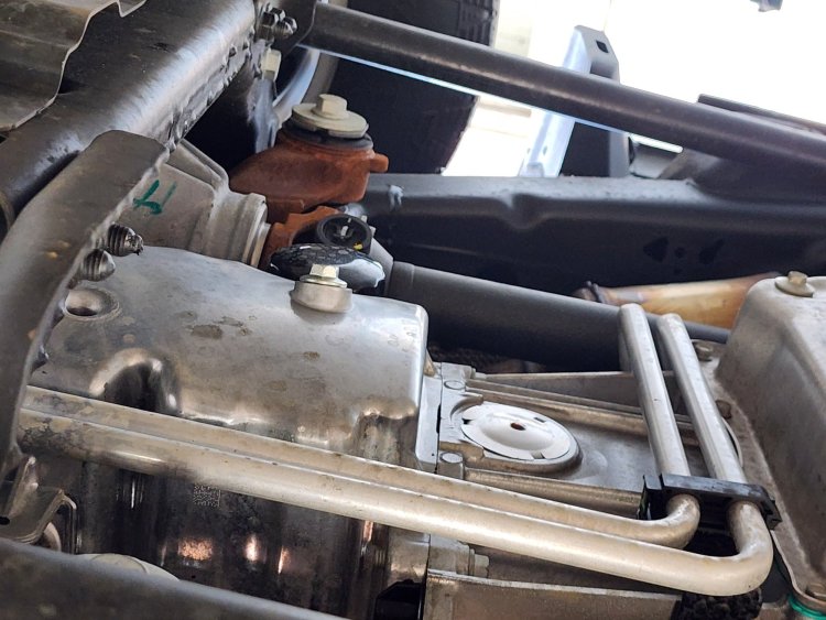

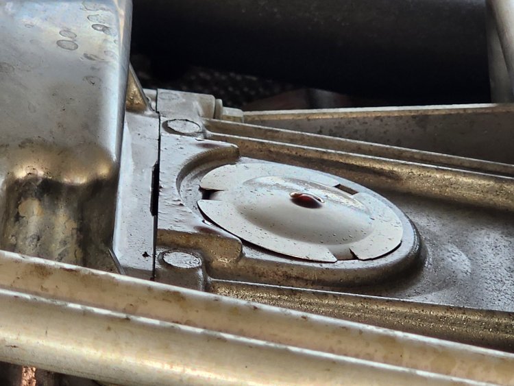

Dealer took a look today, the forward internal cover is leaking around the perimeter.  They ordered a new cover, perimeter seal, and shaft seal.  They topped off my fluid (less than a quart) and sent me on my way.  They said probably a week or two for the parts to come in.
Good to hear they appeared to have found the issue.

Front cover seal replaced.  Ended up leaking again, and the transmission developed bangs and jerks when downshifting and coasting downhill.  Dealer verified and ordered brand new transmission.  Hopefuly will be fixed in a week or so.

this is awesome.  just looked under my 24 duramax and have the exact same image.   I guess they can look at this when they look at the flooded camera and flash the truck so the fog lamps light up.  Really sad we can't get better quality when they want this kind of money for these trucks.  mines just an LT, and i still feel like it was 20k overpriced.  the dash has rattled since i brought it home, and the camera took a poop with about 5k miles on it.....now the oil leak/seals whatever.......this has been an issue at the engine/transmission connection point since before 14' because my old 14 did it from about 60k on, until it was traded......but that was engine oil so i guess this is "different" lol

4 hours ago, Agargano98 said:
Sorry, haven't been here for a while.  Yes they replaced the transmission with a new unit.  Almost 1000 miles and no issues yet.  Keeping my fingers crossed.
Good to hear! Sucks you had to deal with a patchwork "fix" the first time.
