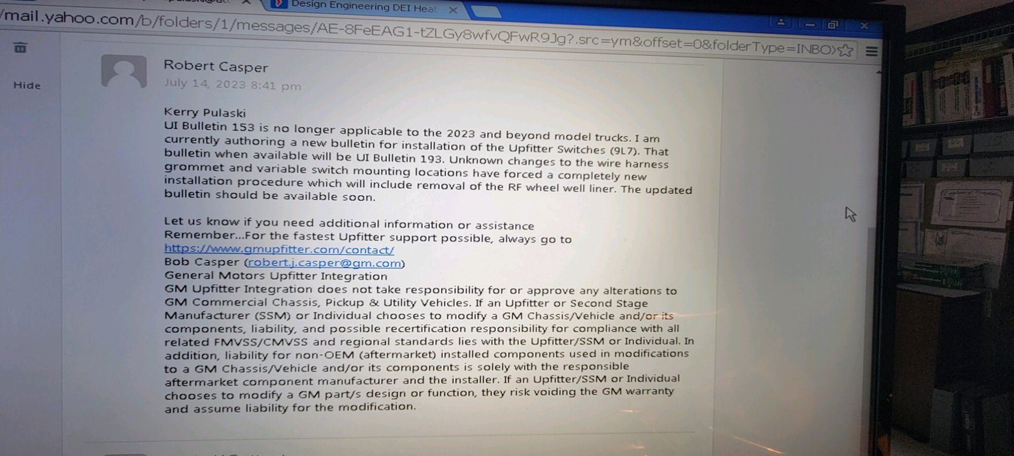

GM Upfitter Eng. Robert Casper replied to my request for 9L7  Update. Said he is the one writing the Installation Bulletin to be # UI-193.  The old UI Bulletin # 153d and #153e  no longer apply to the '23 and '24's.
Said the Passenger wheel well liner will also need to be removed to install the harness.

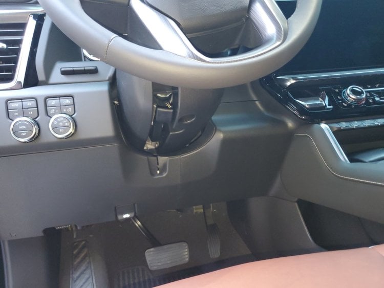

The Pre '23/'24 5 Switch Pod mounted to the left Knee Panel.  On my '24 HD, the Light , 4x4 and park brake controls are there.

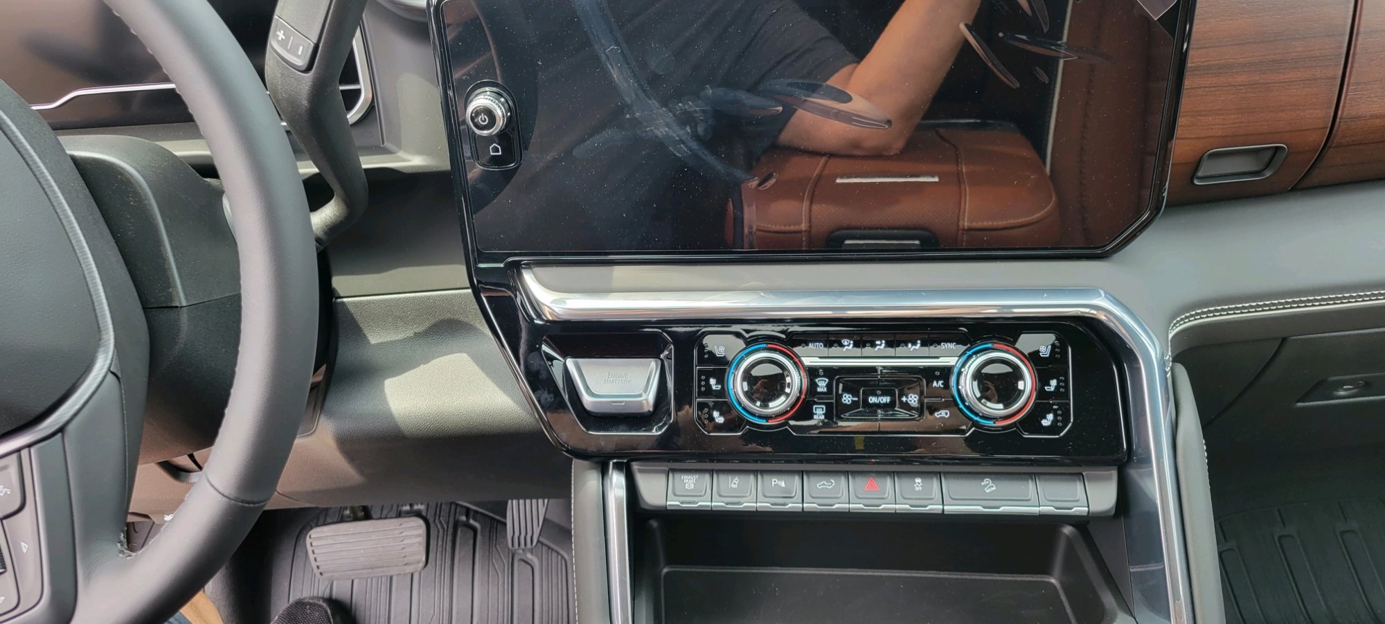

That Pod measured 2.5" x 4" O.D.  It could possibly fit on the right of the steering column next to center console. To the Left of the Ignition Start Switch. It's a tight spot, but the old 5 switch Pod could fit there.
However some say it will be IN the center console, under the existing row of switches.

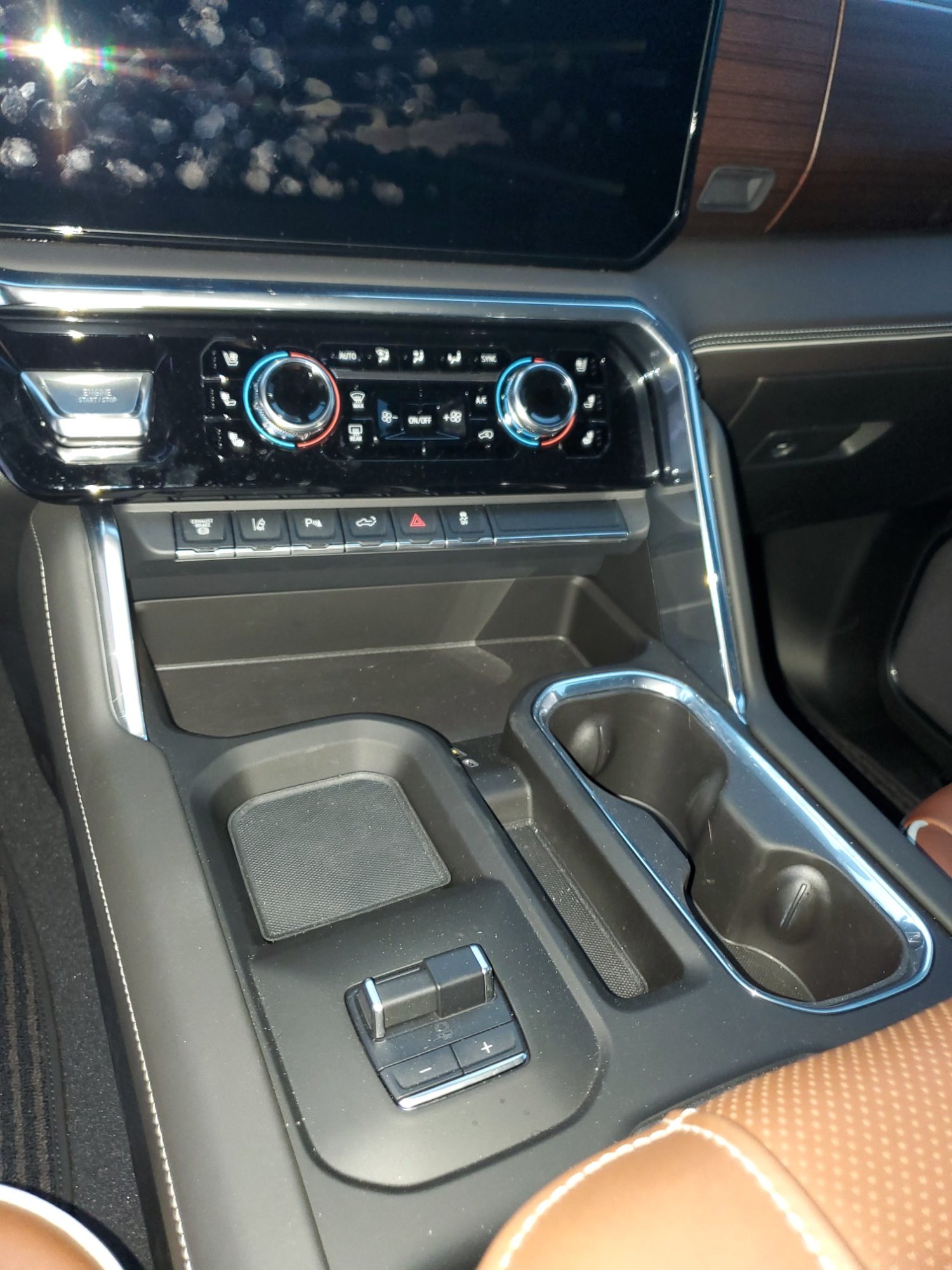

Anyone have a pic of the 9L7  Switches Factory installed  ??

the only part numbers that have change from the 20-23 to the 22i 1500 and 24 HD trucks is the switch's. everything else is the same. you will get a center stack panel instead of a knee bolster to put the new switches in. the wholes for the switch panels are different but i bet you can install the current kit by just making your own hole. Dont know why they would have changed the switch bezel though.
