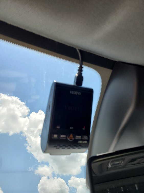

I put mine right next to it in the driver's side.
BTW I used to have a Viofo A129 Pro Duo 4K setup and I thought it was an OK setup. I got a Rexing V1P Max and it's more user friendly IMO. I'll post a pic later today
4 hours ago, dieselfan1 said:
Here you go.....
Does that have the lane keep assist?  I know with the Viofo, it was picking up the lane keep's huge box
