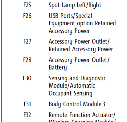

F26 USB Ports/Special Equipment option Retained Accessory Power
F27 Accessory Power Outlet/ Retained Accessory Power
F28 Accessory Power Outlet/ Battery
When on 'battery' the accessory power outlet should not shut off.
Perhaps get a power port/usb adapter to power your goodies
Be sure the draw will be low enough that it doesn't drain the battery - there have been lots of reports of items left plugged in that will drain the battery.

The stuff I posted previously was cut and paste from the 2023 owners manual - for the instrument panel (right hand) fuse block.
(the other panels (left hand instrument panel & engine compartment) also use those fuse numbers....seems like a bad idea on GM's part...I'd think each fuse panel should use a different set of numbers, but they didn't call and ask for my opinion)
I think the right hand panel, F27/F28 thing is an either/or fuse.
The location selected (F27 or F28, instrument panel fuse block on(on passenger side) determines how the power outlet (not the usb's) will function.
Right hand panel has fuses on both side.
Here is a screen grab of the info from my prior post.

According to the manual, the USB is powered by F26, not by F27/F28 -- which are for the power outlet.
