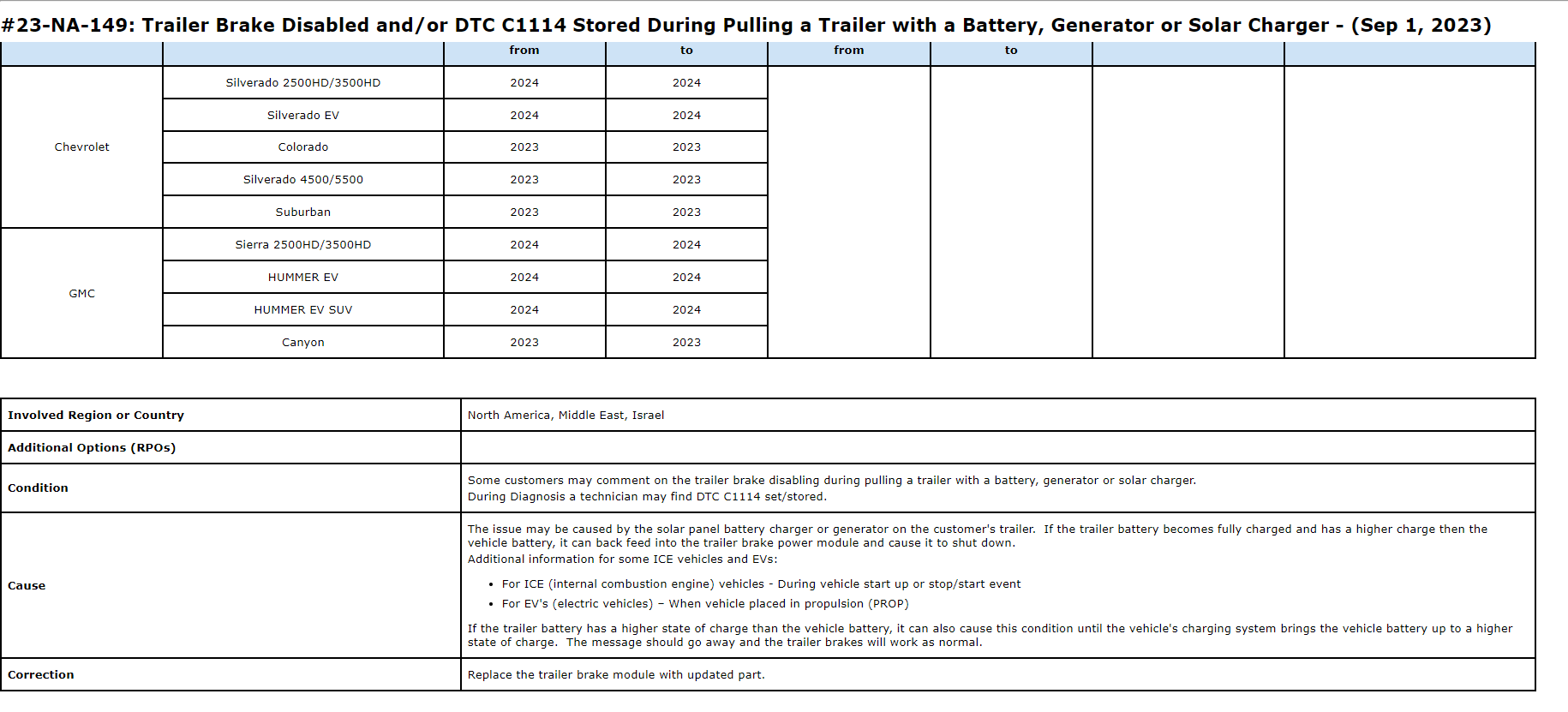

Opened the bulletin today and it has been updated to include the terms "trailer with a battery" instead of just solar/generator.
Fix is to replace the brake module with an updated part which I'm pretty sure is just the old brake control module from the previous trucks.

The fix is the trailer brake power module that was on the HDs in 2023.   The light duties are currently building with this part.  The models that are affective are:  2024 HD, 2023 mid size truck, and GMC Hummer.

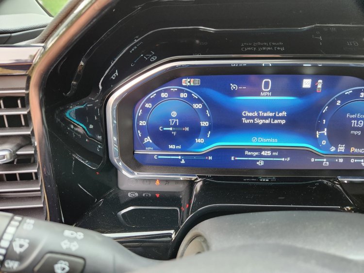

I tested a theory today based on the new information about the trailer voltage and the solar panel charging issue. When I first hooked my 2024 truck up I had a number of lighting error messages and difficulty getting the TPMS sensors to pair. After reading about the issues here I decided to test the trailer again. Normally the trailer is stored in the pole barn and it is plugged in to 110V power all the time including if its parked outside occasionally. When I got the truck the trailer was outside but still plugged in to 110V. This means the converter was float charging the 2 12V batteries on the fifth wheel.
Today I disconnected the trailer for a few hours and pulled the truck back under the trailer and connected the 7 way and everything works perfect.

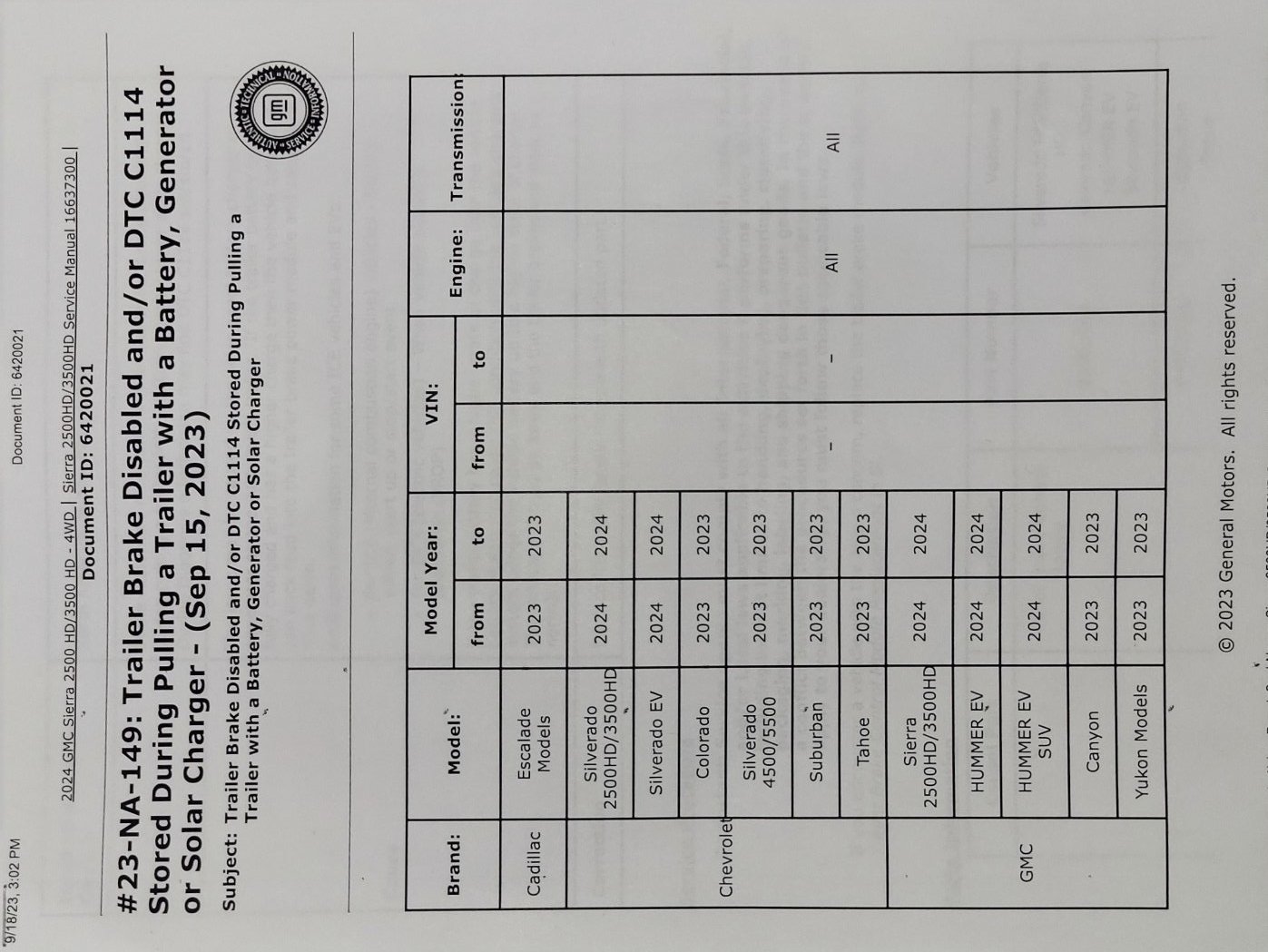

Do you have a copy of the 23-na-149 bulletin?

Went to the GMC dealer for service yesterday and asked about the bulletin and if they had updated info from GM.  Got them to print out the new updated bulletin.  Looks like they added in some 2023 models to the list.
Correction for the issue is listed as "Replace the trailer brake module with updated part", and lists the part number as 23306694 for (Sierra HD) which matches the 2023 brake controller.  I had them order the part and will have them put it in when it arrives.
