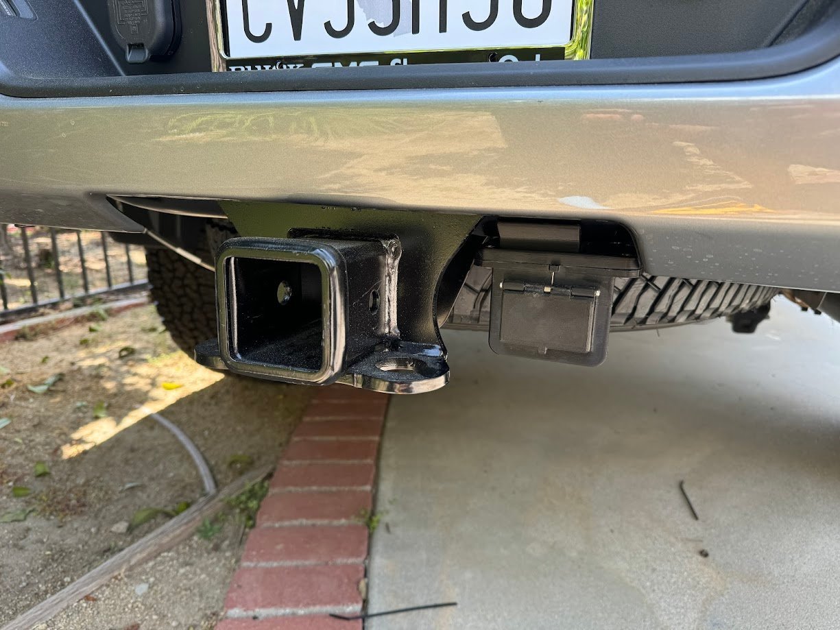

I also have a 120A Anderson connector on the back of the truck with a mating cord on the trailer. My trailer has EOH brakes so I just run the brake pump/controller off the trailer battery bank which is 560AH lithium.
the 120A Anderson connector is in that housing to the right of the receiver.
