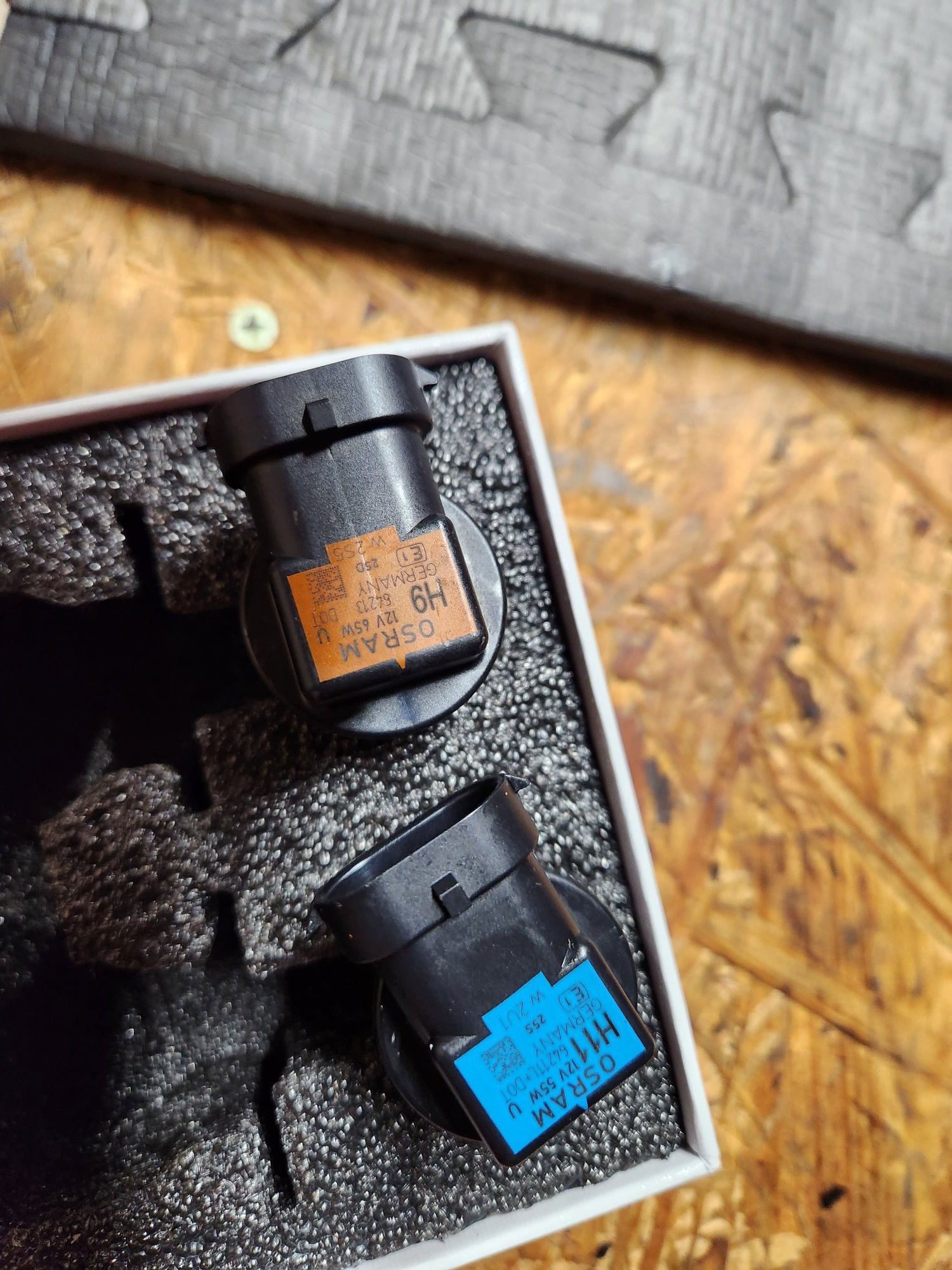

I put the Lasfit H11's in my LT and its an entirely different experience when driving at night. For less than $100 its a complete transformation. https://www.lasfit.com/products/lcplus-h11-h9-h8-led-headlight-bulb?rq=na_led-bulbs~mk_chevrolet~md_silverado-3500~yr_2023~zq_lt~dz_low-forward-lighting
(same lamp for high and low)

So does a guy need two sets of those? Two bulbs for each side?
I really should do it. On occasion, depending on conditions, it almost appears the lights are off! When driving.
You seem to have a solid grasp on electrical. Is there any reason to fear our electrical system with these bulbs? Like could they stress the wiring?
Thanks.
You would need 2 sets. My lows were H11 and highs were H9.  The H11 LED bulb will fit in both high and low. As far as wiring the LED's pull less power than the stock bulbs so I dont anticipate any issues. They have really improved the quality of them over the last few years. There are even brighter ones than what I put in my truck but I wanted something that was still reasonable rather than blinding all the oncoming traffic.  Your truck should be the same as mine. The fender liner needs to be pulled back by removing the front 5 or 6 screws (T15) and pulling the liner back. There are some issues with tight spaces so dont be in a rush.

Installed 2 sets of LASFIT LAplus H11’s in my custom. Had to aim them down a bit with a long hex wrench. Performance-wise, they aren’t perfect but maybe 75% of what you get out of an OEM setup IMHO.
