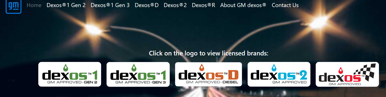

Dexos2 is diesel oil for the 2.8L
DexosD is diesel oil for the 3.0L
The 6.6 Dmax uses the same ccd/CD oils as other large diesesl
DEXOS 1 (gen1, then gen 2 and now gen3) are the gasoline engine ones.
Kirkland pic in the first post appears to be Dexos2 -- which is not spec'd for any engine used in the 1500 or 2500/3500.
Dexos2 would be for the 2.8Lwas used in the Colorado/Canyon twins.
Current list of oils that meet the various Dexos specs can be found at:
https://www.gmdexos.com/index.html

Dexos2 also covers Euro gas engines and until the DexosR came about, covered Camaro and Corvette 2019-2023.
