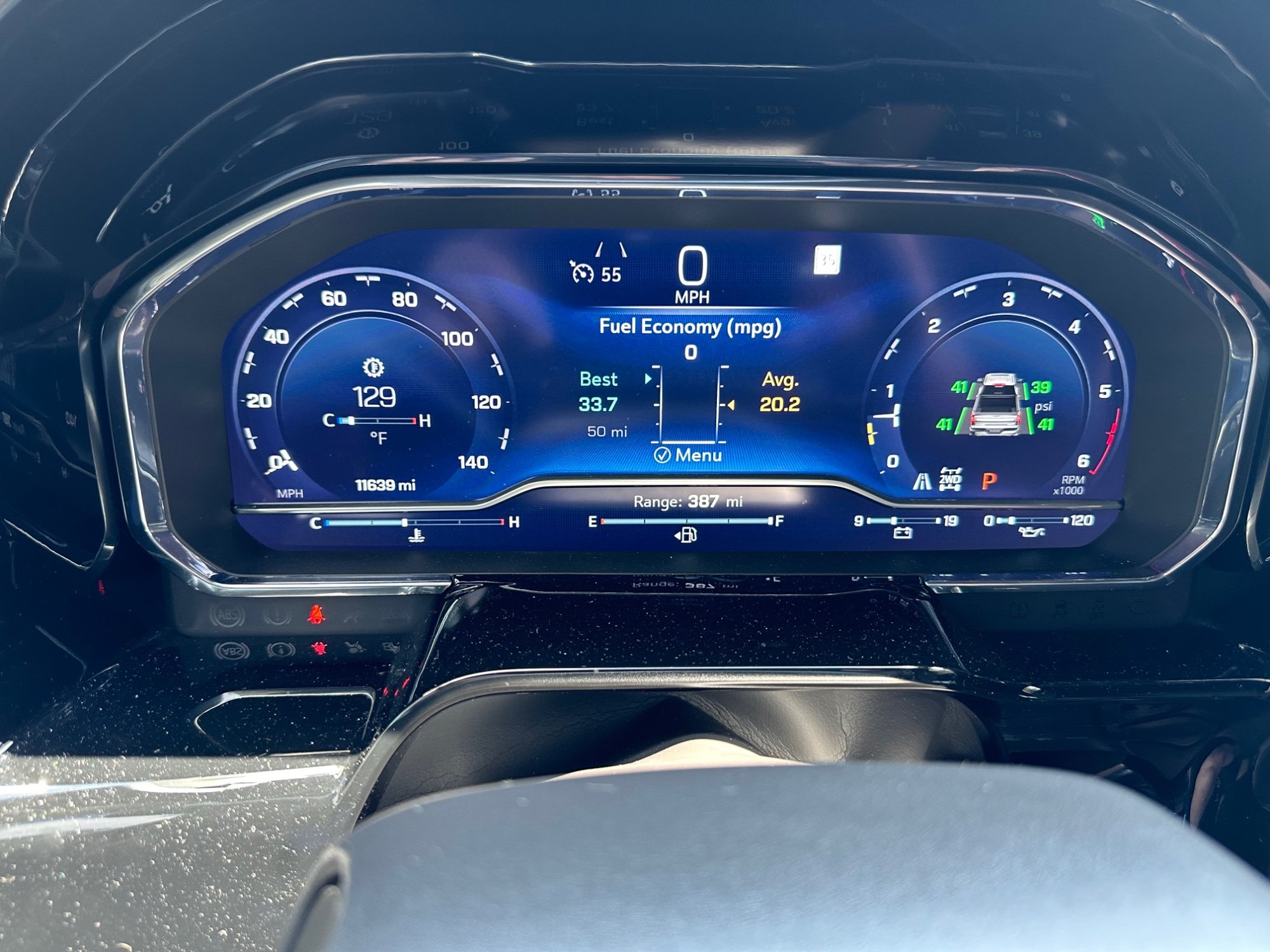

Yes. Those are normal Temps.
I installed a PPE Trans Cooler, PPE Thermal Bypass, and PPE larger capacity Transmission Pan. Best thing I ever did. Transmission runs 130 degrees and never really deviates from that. When I stop cools a few degrees immediately.
Just wondering out loud, at what point is the trans temp too cool?  I've read a lot of varying opinions, some suggesting you need to get at least into the 170-180 range on these new 10 speeds?  I've never heard of a trans running at a normal operating temp of 130.
I had a 2023 Silverado with the 5.3 and 10L80 10-speed for a rental earlier this year. The transmission temperature stayed between 130-140 at all times. It is the same 10L80 that is in the 3.0 Duramax trucks.
I will keep my PPE cooler and PPE bypass valve in. 190+ temperatures are not good for a transmission.
It's an interesting discussion as this vehicle is definitely running higher than what my past trucks used to run.  I've actually driven a number of 2021's through 2023's and they all ran in the 185 to 195 range. This seems to be the factory target.  Definitely not a range I'm comfortable with.
