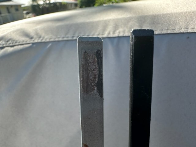

Update on my experience with the tailgate.
I bought the new hinge and dampener and plastic bushing, seemed to make a difference, still not soft open.
I thought about the torque rod and ordered one.
Well, I inadvertently bought one for the previous model years, but it took me a long time to figure that out, way longer than a sane person would do.
I spent an hour trying to make it work, then, I looked at my old one and the diameter of the torque shafts were different.
My original one had a larger diameter and that's why I could never tighten the incorrect one for torque and tailgate lowering.
Anyway, I reinstalled the original torque shaft, tightened it back up, and, now, it's back to like new! In the interim, I ordered another, thinking my original one was failing, somehow.
I dunno why, but it seems removing it and reinstalling it brought it back to life?
Well, I have two torque tailgate rods now, one for the K2s and one for whatever generation that was prior.
I'm gonna go bang my head up against the wall for a bit...

It seemed to me the rod just needed to be removed and reset.
There was no cleaning involved as, other than some dust, it was fine (refer to the previous pics.)
Once I realized I had the wrong part, I replaced the old one and, quite frankly, it operated as well as the new one I installed.
To summarize, I would recommend removing and replacing the old torque rod before purchasing a new one. Still, the tailgate does need to be removed and set vertically for a proper fitment. A bit of a pain doing it by one's self.
OK, time to go back and reintroduce my head to the wall again ...
