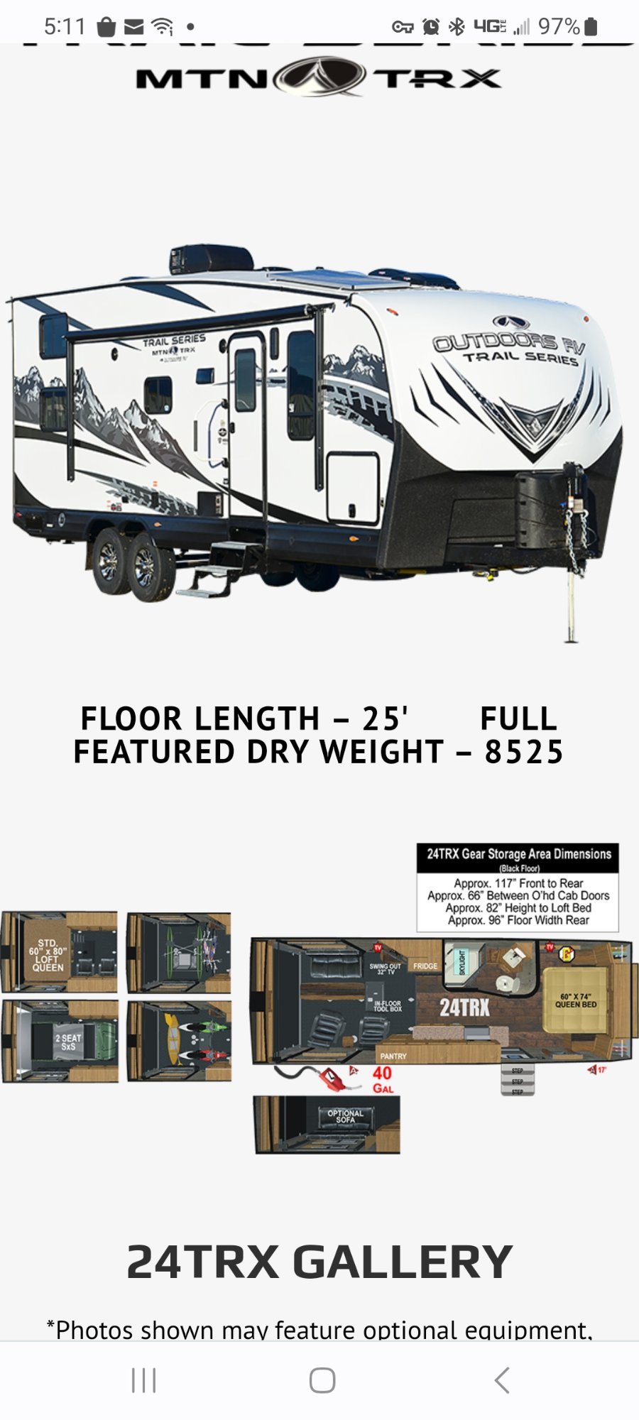

This is one of the toy haulers I am considering. As you can see the dry weight is way under my towing capacity, but the tongue weight is really close to my limit. This is the shorter one of the bunch. The longest one has a 1600# dry tongue weight. I do not like being so close to my limits when the trailer is dry.
Now, with toy haulers the "toy" gets loaded in the rear and that will reduce some of the tongue weight. How much depends on how much weight gets added to the rear. But there are variables which will constantly change as well. Such as this trailer has a 100 gallon water tank. Whether it is full or empty is going to change the tongue weight. If that water is in the black and grey tanks it is going to change the tongue weights. The trailer has a 40 gallon fuel tank too. How much weight is stored in the front storage area, as well as other stuff stored in all areas of the trailer is going to change tongue weights. The list goes on.
The point is, there are times when it's entirely possible to be a few hundred pounds lighter or heavier than the dry tongue weight. I plan to adjust rear weight as needed to keep my tongue weight in spec.
However, what if I wanted the 29TRX? It's dry weight is also under 10k#s. That's well within my towing capacity. But the dry hitch weight is 1600#s. So, while I could add my toy to the rear and probably get the tongue weight under 1450#s, I couldn't ever tow the trailer dry without being over the limit. Hence my anger. I would like the larger trailer, but It's too tongue heavy...

I commend you for doing your research on the weights.  So many times people are out there saying...oh yeah, my ford escape tows 12k pounds no problem....lol....but seriously I do commend you for trying to figure out the weights to stay within the ratings of your truck.  That makes you a safe guy!!  I love that!!
