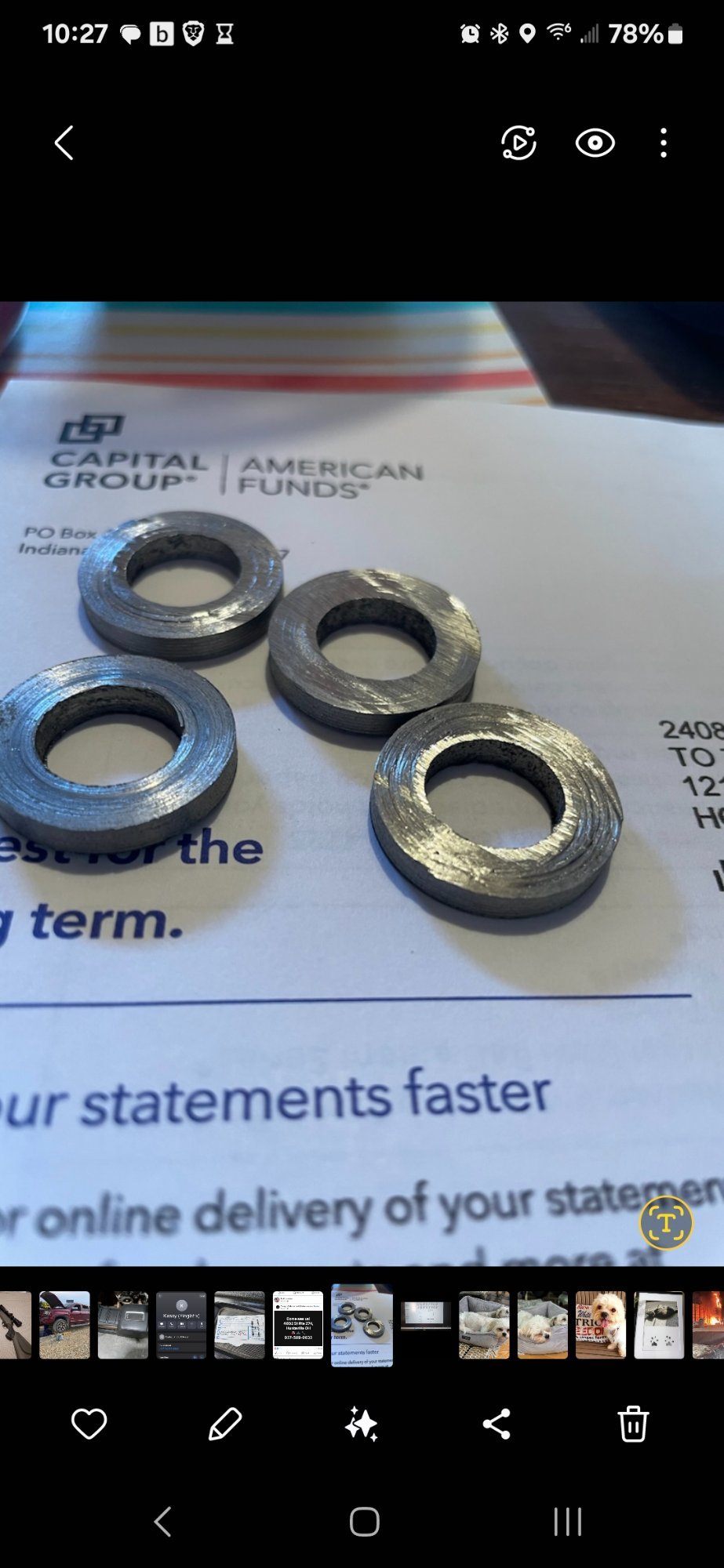

1 minute ago, Homewrecker007 said:

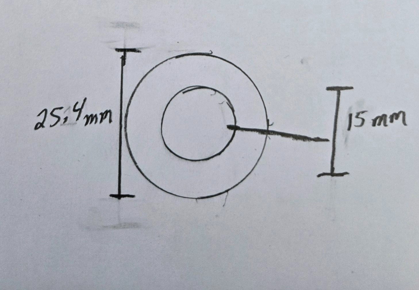

The 4mm spacer? My dad made mine. But most people just use 2 flat washers stacked together
you got pictures of your setup when you put it on? Id like a spacer that was specially made not washers, only the best for baby girl lol

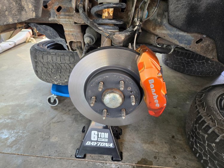

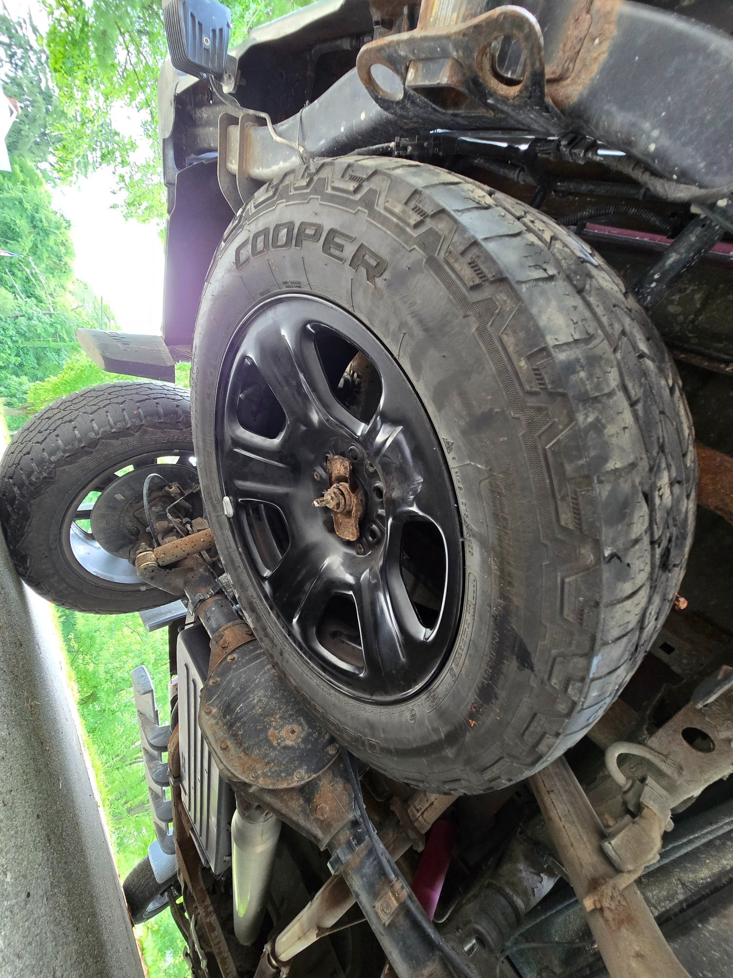

Yes, I do.Screenshot_20241124_222733_Gallery.thumb.jpg.1371d2b89574af8e2bcc2e53ad0725fc.jpg20240731_154357.thumb.jpg.2914a3c785138f31b02d2064b07a2b29.jpg20240731_154347.thumb.jpg.c385441ac5a9bcbfad29b0ef7fbd1bbb.jpg20240731_134807.thumb.jpg.a2ac99fbc4d73fad004b66cedd5e6da7.jpg

8 minutes ago, Pinnacle said:
Oh that's sex 🙌
Thank you, just FYI I didn't actually have to shave down the calipers to fit on the front.  My wheels cleared. I was just trying to make Banshee look like a bougie b!#$%.
lm running snowflakes stocks, I don't think they touch
