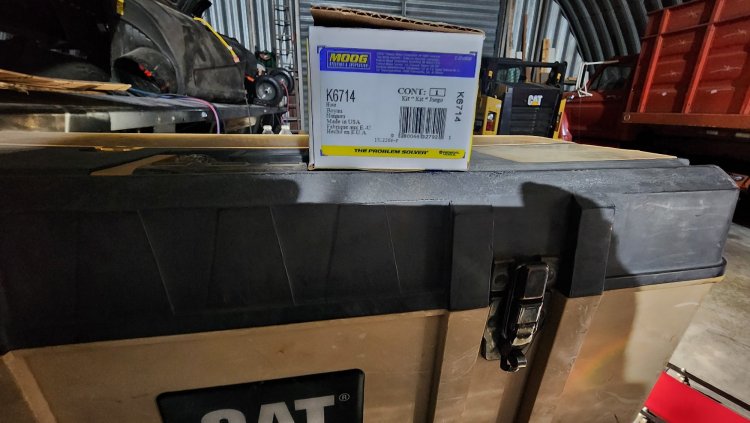

I went out the trashcan and took a picture, before I realized I bought them from amazon.
Moog K6714

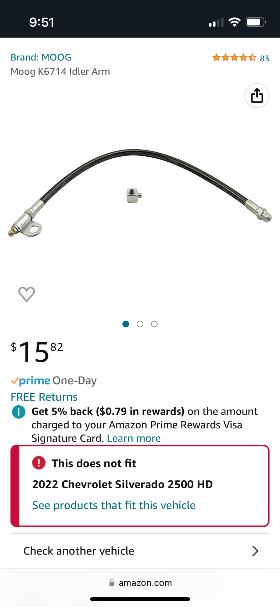

Amazon is dumb. This is the message I got.

Yeah, I think it has to due to it not being a factory part. Either that or big A doesn't know a real work truck needs greased.
