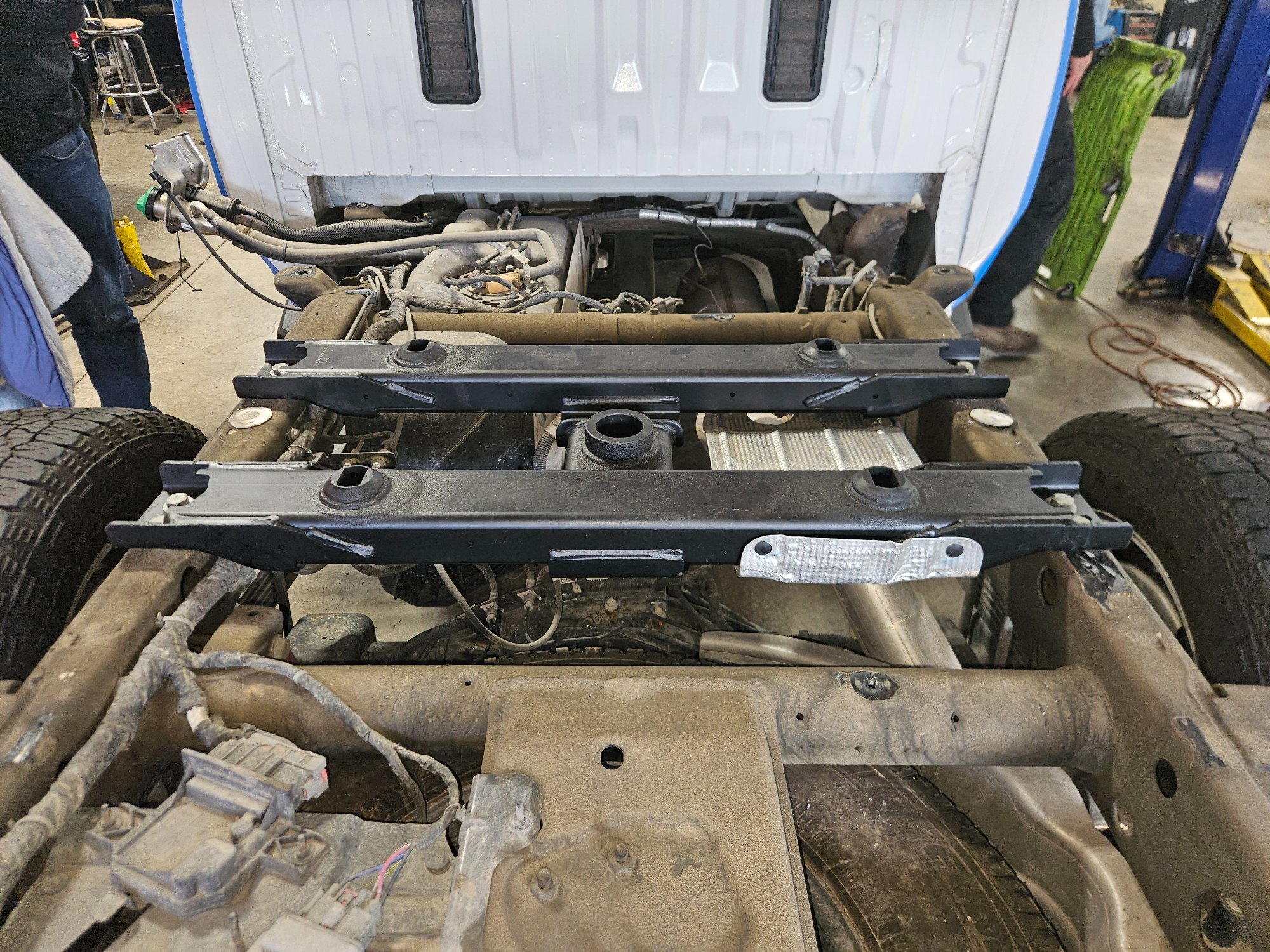

On 10/29/2023 at 6:01 PM, gemarsh said:
Did you see a reason why you couldn't have turned it 180° to get it over the axle like a long bed?
I read it was because of a crossmember. I don't see it from your photos.
Then I read it was for turning clearance with the cab.
If you look at the hitch there is a u channel in front of the ball mount.  This is for clearance for a stiffener on the underside of the bed itself.
  • Thanks 1
A BED crossmember. I didn't see that coming. Thanks.

Finished up my installation this past weekend. I went to a dealership and took some measurements from a similar truck with the puck system installed.
Here are the measurements I used for the holes:
Here's how the holes turned out:
Pretty much spot on.
The gooseneck hole is a little too big for the OEM cover. I used a 4 inch hole saw. Probably 3.75" would have been better. I also only cut circles for the 5th wheel pucks so far (those I cut 3.5 inch holes). I am going to try using the Ford style covers. I have an extra set from my F350. I like those a lot better than the GM covers. The GM covers seem like they would get dislodged pretty easily. Plus you have to cut notches into two sides of the holes for covers to lock into. Otherwise the will be too big and won't sit in the holes nicely.
