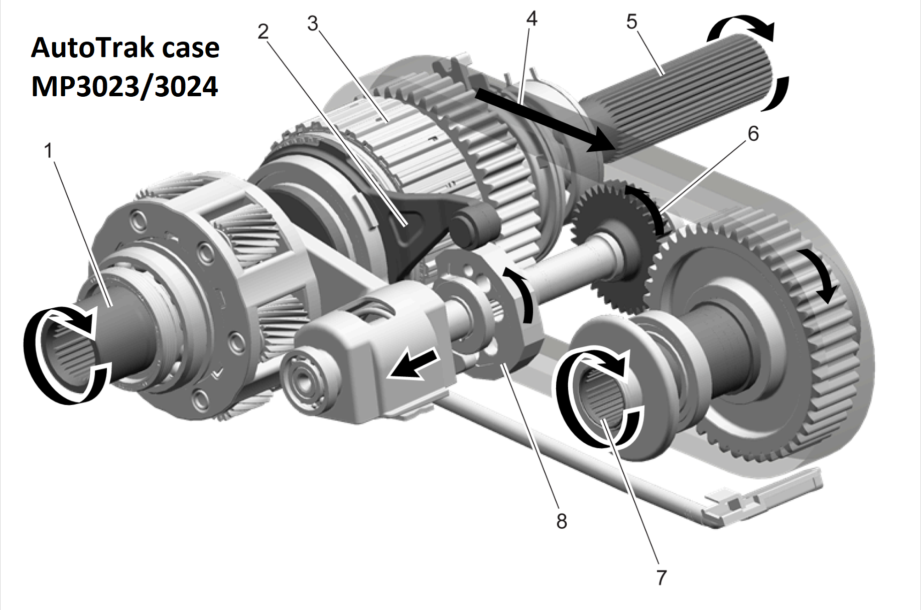

No.  Non AutoTrak cases do not have that clutch pack.  No software update to turn one into an auto truck.
Inside of the AutoTrak case:
(1)Transfer Case Input Shaft
(2)Transfer Case Scissor Mechanism Lever
(3)Transfer Case Four Wheel Drive Clutch
(4)Transfer Case Front Output Shaft Drive Chain Assembly
(5)Transfer Case Rear Output Shaft
(6)Transfer Case Two/Four Wheel Drive Actuator Shaft Gear
(7)Transfer Case Front Output Shaft
(8)Transfer Case Two/Four Wheel Drive Actuator Cam
2, 3, 6 and 8 are the key bits to the AUTO mode.
