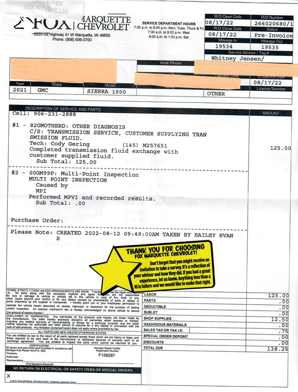

My dealer wants $630 for trans fluid change in my 2019 10-speed. I am shocked. I will be shopping around.
My dealer charged me $130 to exchange out the fluid in my 10sp and I provided the fluid.  So that is an option.
600 is a rip off price.  I took my GMC to this Chevy HD truck dealer because they had a dedicated trans tech whereas the GMC Dealer (same company-different location) had ech with very limited trans experience.
PS - The Service rep "Whitney" told me the tech said to tell me he uses AMSOIL as well.  Thumbs up.
