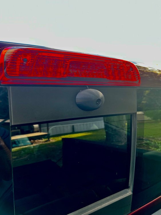

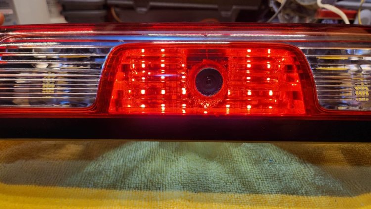

On 4/13/2023 at 5:58 PM, jpinoy said:
Finally got around to installing the camera into the brake light. Need to get used to the depth perception with the camera when driving.. 😅
I used a Dremel first, them a step bit. I opened it up from the inside, then finished it off with a down angle. I used the center dimple as well.
My main thing was to see into the truck bed/rear when my Bakflip was all the way up blocking my view and this does the job.

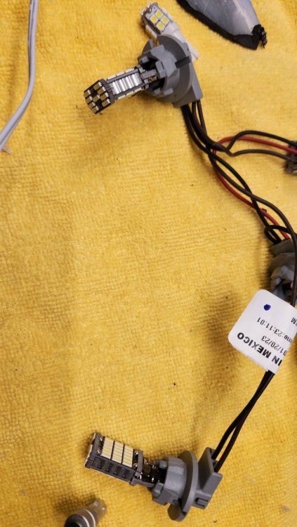

I also knew the brake light bulb was going to be an issue, so ordered two 6" LED strips and used those as the brake light, turned out really nice. I already had LED bulbs in there. I upgraded the lights to brighter LED as well. Swapped out my brake flasher with one that had a timeout feature.
