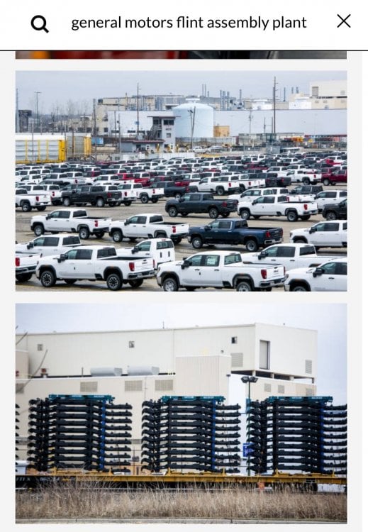

Seems that for the last 20 or so years whenever GM comes out with a new HD truck or an MCE update to an existing HD truck rumors start that GM will finally go to some sort of E-coat and get rid of that messy wax coating they have used since 1987.  The 2024 update is no exception, I have heard that the goo is finally gone and new E-coat equipment has been installed at Flint (funny, I thought the frames were vendor supplied).  The wax coating (actually called Nox-Rust) first appeared on the GMT-400 trucks in mid-1987 and by the mid-90's Ford and Chrysler were using it as well.  I always thought it did an adequate job of protecting the frame and liked the fact that it's easy to touch up (the material is available in spray cans) but it is messy, dirt sticks to it like crazy, and it needs to be touched up A LOT under certain conditions.  On the other had I would have to say that outside of certain Toyotas pickups Ford F-150's seem to me to have the most frame rust issues, and they have been E-coated for years.  Nonetheless, judging from comments on many pickup truck forums, many GM truck fans would like to see the wax replaced.  Both Ford and Chrysler dropped the wax years ago on their full size trucks, and GM does not use it on the Colorado/Canyon or any medium duty cab and chassis models.  So, what is the story?  Why has GM stayed with wax dipped frames for so long on certain trucks?  Will GM change to E-coat?
