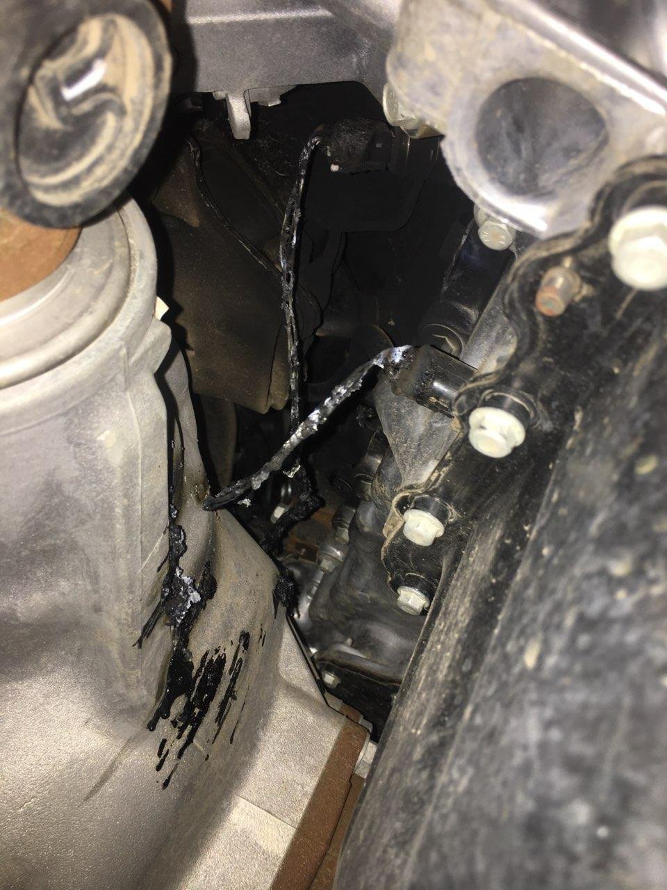

2022 GMC Sierra 3500 Denali DRW. Used the block heater on a 9°F night, next morning all kinds of lights and warnings came up on the dic. Had 3 crank no starts. Un-hooked batteries for an hour and it did start, with codes.
Limped it to the dealer, Sunday.
Call from dealer said complete engine wiring harness needed. GM engineers to come take a look. Will be down for awhile but alternatively, I will have a truck to get back into.
Got some pictures from service manager. Still waiting on inspection.
