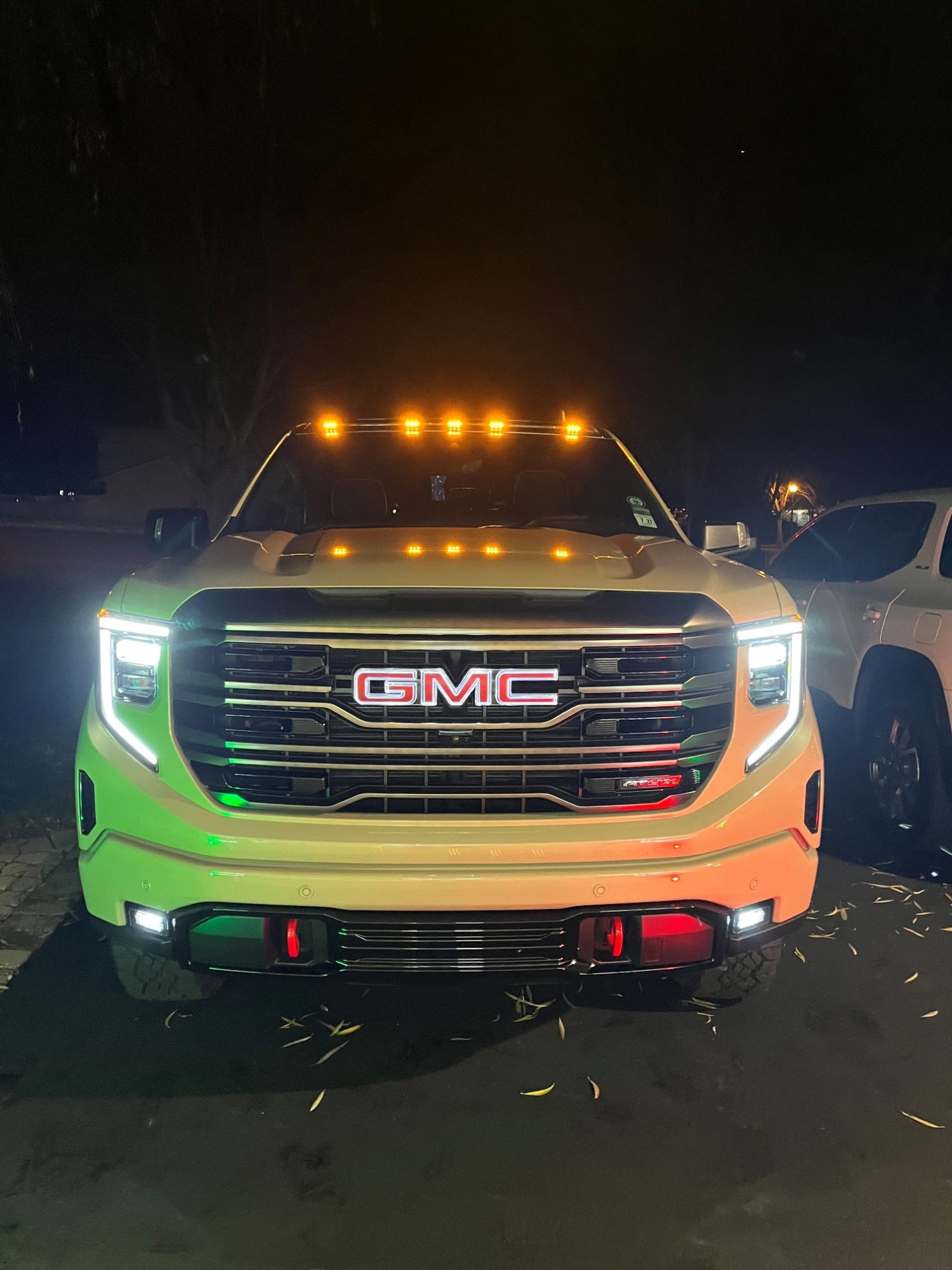

DenaliBQ Posted December 10, 2022 Share Posted December 10, 2022 This rig needs some tow mirrors please someone help !!!!! Quote Link to comment Share on other sites More sharing options...
