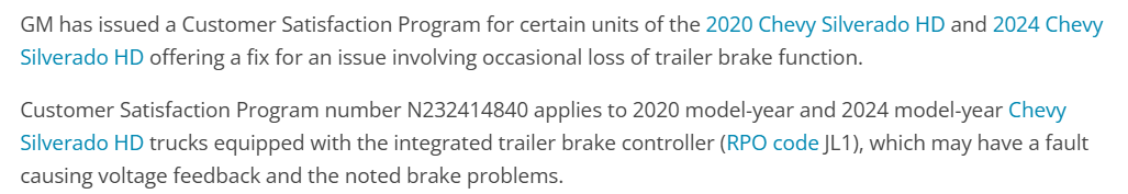

GM To Fix 2024 GMC Sierra HD Intermittent Trailer Brake Loss (gmauthority.com)
The 24 models have a different electrical architecture and the trailer module is different than the 23 and earlier.
Some of the pre 24 issues were related to other things like plug compatibility.  I changed my trailer plug to a Pollak to match the OEM on the truck in order to avoid issues. I havent had any on the 24 but my trailer doesnt have solar.
Dealer contacted me today to inform me that the module arrived. I have an appointment to get it replaced on Aug 6. I won't know if it fixes anything.

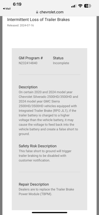

It can happen even if you don't have solar if you have fully charged lithium batteries.

We’ve only got flooded lead battery on our travel trailer. The only camping trip we had left last fall after getting the truck the brakes disconnected and reconnected a couple dozen times. I got the controller replaced before camping season this spring and it did correct the issue. So just a heads up that it’s not just  a solar or lithium issue.
I have an appointment to get the recall completed next Thursday. I will give an update once I get it completed.

Module replaced
amperage prior to module replacement was 10.2 amps. Hooked up to the same trailer, amperage is now 14.4 amps.
