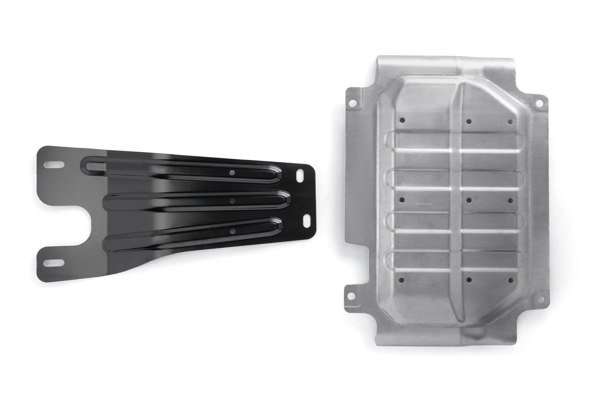

I bought a 2022 Silverado 1500 High Country several months back.  As you all know, it's almost impossible to find exactly what you are looking for on a lot these days, and ordering can take a ton of time (if you find a dealer with allocation).  I always get a truck with the Z71 package, mainly because I do go offroad in Northern Maine for hunting every year, and the skid plates are a must for that terrain.
This particular High Country DID NOT come with the Z71 package, unfortunately.  I've got a moose hunt coming up in a month or so up in Maine, and I'd like to buy and install the skid plates that would come with the Z71 package, but can find little to no information on part numbers for the plates, etc.  I'm not even 100% certain I can add them, as I don't know if the bolt arrangements on the undercarriage of the High Country are pre-drilled to accept these plates or if the Z71 trucks have additional anchor points drilled out at the factory.
Any help would be appreciated.
I’m not really sure what all skid plates you get, I think it may just be the one under the transfer case. If so, you’re not missing anything at all, it’s kind of a joke and not worth the hassle.
If you really need skid plates look into aftermarket products that will actually provide you with some protection.

All the holes are there.
Z71 gets you oil pan and transfer case.
GM has a kit 84962765 which gets you the ZR2 style skids for the oil pan and transfer case (bigger than the Z71 plate).  It works out cheaper by a bit vs. buying the regular Z71 spec ones and all the hardware as its all individual.
Being you have a High Country you should already have the 2 speed transfer case, so the only other things you would be missing from Z71 is the Ranchos (big deal) and the Hill Descent Control (can't be added).

Yeah I've had a number of Z71's in the past, so I know the majority of the "package" is fluff (I mean, it's only like $200 extra).  I don't need the decent control, and the Rancho's aren't anything special.  My larger concern, because I do go places where the road is washed out, or tire tracks are cut out pretty low and the transfer case and oil pan can/do make contact with the ground (and/or there are a ton of sticks and crap that poke up from the ground).  I wish they had a gas tank plate too, as she's pretty exposed as well.  Those old logging roads up in northern Maine are ROUGH.
I think I'll go ahead and try to order that ZR2 package.  I assume I can just visit the dealer and put that bad oscar on order?   Appreciate the help!

I've got a Z71 and I've bent the flimsy shield for the transfer case a couple times.  I just bend it back with a small pry bar once I get home and never think twice about it.
However, the ZR2 version looks much more robust, does it bolt right up?
