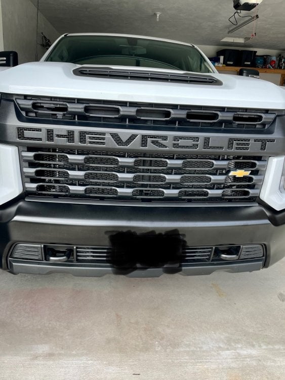

Anyone done this “mod”?
its painted aluminum so it shouldn’t rust. I used a combination of fabric Velcro ties and then did a standard zip tie over that. Mainly to protect the plastic grill. Everything is tight and not going anywhere.
these trucks have gaping grills and little protection. Even a small bird could go right into the condenser, radiator etc.
I figured for 17 bucks online it’s not a bad idea. I’ve seen how bad the fins get with much smaller openings so I can imagine this truck would get blasted.  This still won’t keep everything out but it’s going to be wayyyyy less than stock.
also if you’re wondering, this didn’t restrict airflow at all. I have a scan gauge in the truck and the water temp is exactly the same before and after adding the mesh. Truck runs 198deg on average btw not the “210” the dummy gauge says on the dash.

It’s 11x25mm hexagon. It won’t make any difference. They are pretty big holes.
Is it the condenser or tranny cooler in front of the radiator? I’d guess when those fins get hammered with rocks and close up it would be way worse.
main reason I added it is my last vehicle took a big rock to the condenser and it leaked all the refrigerant out.

You can access the grill by taking the whole front end off absorption you can just remove the black plastic top plate and put the mesh on from above, which is what I did.
there are about 8 plastic pop plugs that you pry up with a body fork tool or a flat head screwdriver and you also need to remove the two T10 torx screws holding the hood release lever on and that whole black plastic cover comes off. Takes a few min.
the mesh I bought off Amazon. It comes in 40x13 inch pieces and I literally used the whole thing. If it was about 42-43” it would be perfect. It comes in many hole sizes and even a few shapes. It’s only 15-18 dollars and it is aluminum.
it’s pretty self explanatory once you put the piece down there how it will attach. Mine is attached to six different locations.

You might post a link to the material you used to help the next guy out
https://www.amazon.com/AggAuto-Universal-Grill-Mesh-Multifunctional/dp/B08T8HBHNL/ref=mp_s_a_1_1_sspa?crid=1A4HZ31ON1G2B&keywords=agg%2Bauto%2Bgrill%2Bmesh&qid=1663781742&sprefix=agg%2Bauto%2B%2Caps%2C107&sr=8-1-spons&psc=1&th=1
they have many different styles. I went with the 11x25mm hexagon because it’s not too small and still provides a lot more protection than nothing.
