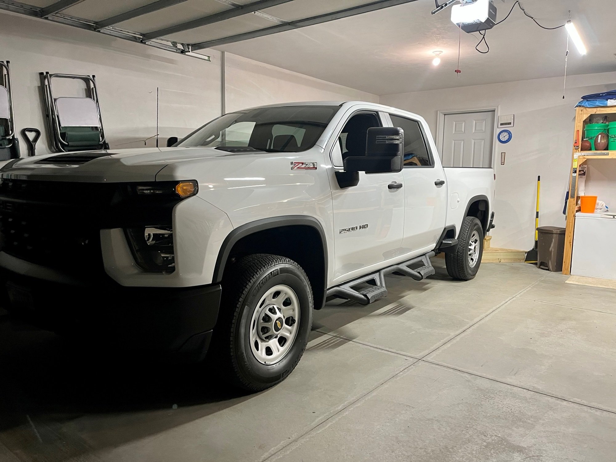

So I installed a set of Tyger lander drop steps and husky liners in the rear tonight on my 22 2500.

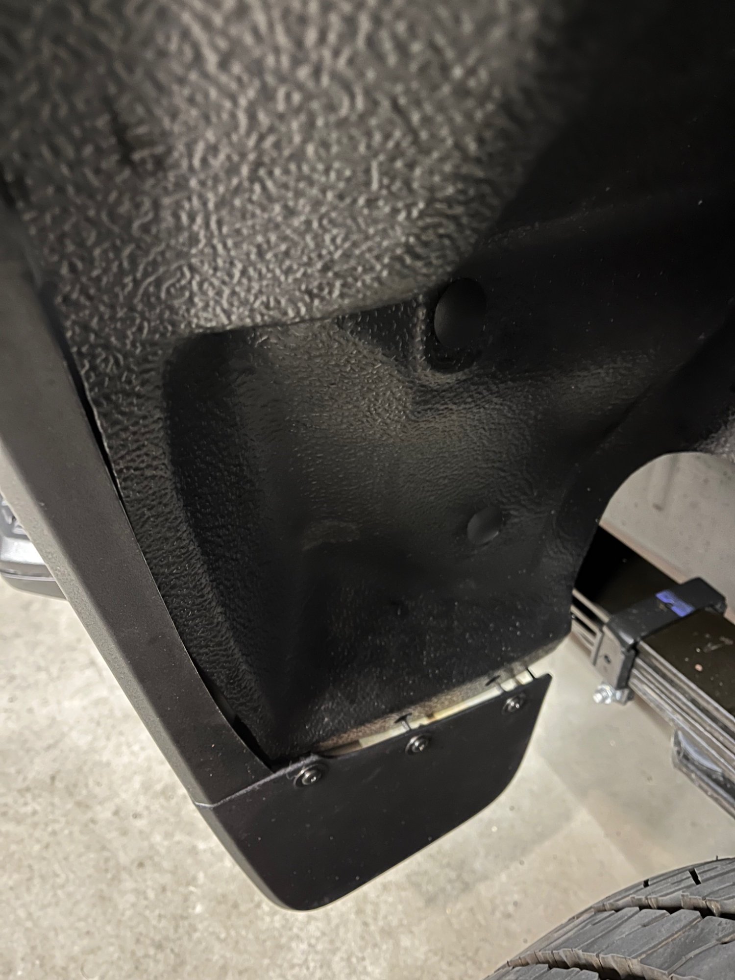

the husky’s went on first and the drivers side fitment is not great at all. They should be about 3/8ths deeper all around the wheel lip.  The passenger side is much better.
I can’t believe they didn’t design them to mount into those 3 screw locations at the rock guard locations. They basically just sit down there front and back. Unless I’m missing something??
they are held on with 7 Christmas tree clips only.
I would’ve went with factory but they are no where to be found. When available I may upgrade.
now onto the drop steps. They went on great and with no fuss or fit issues. They are rock solid and look good with my white and black W/T I think.
you just want to measure each side to make sure they are adjusted just right before cranking them down.

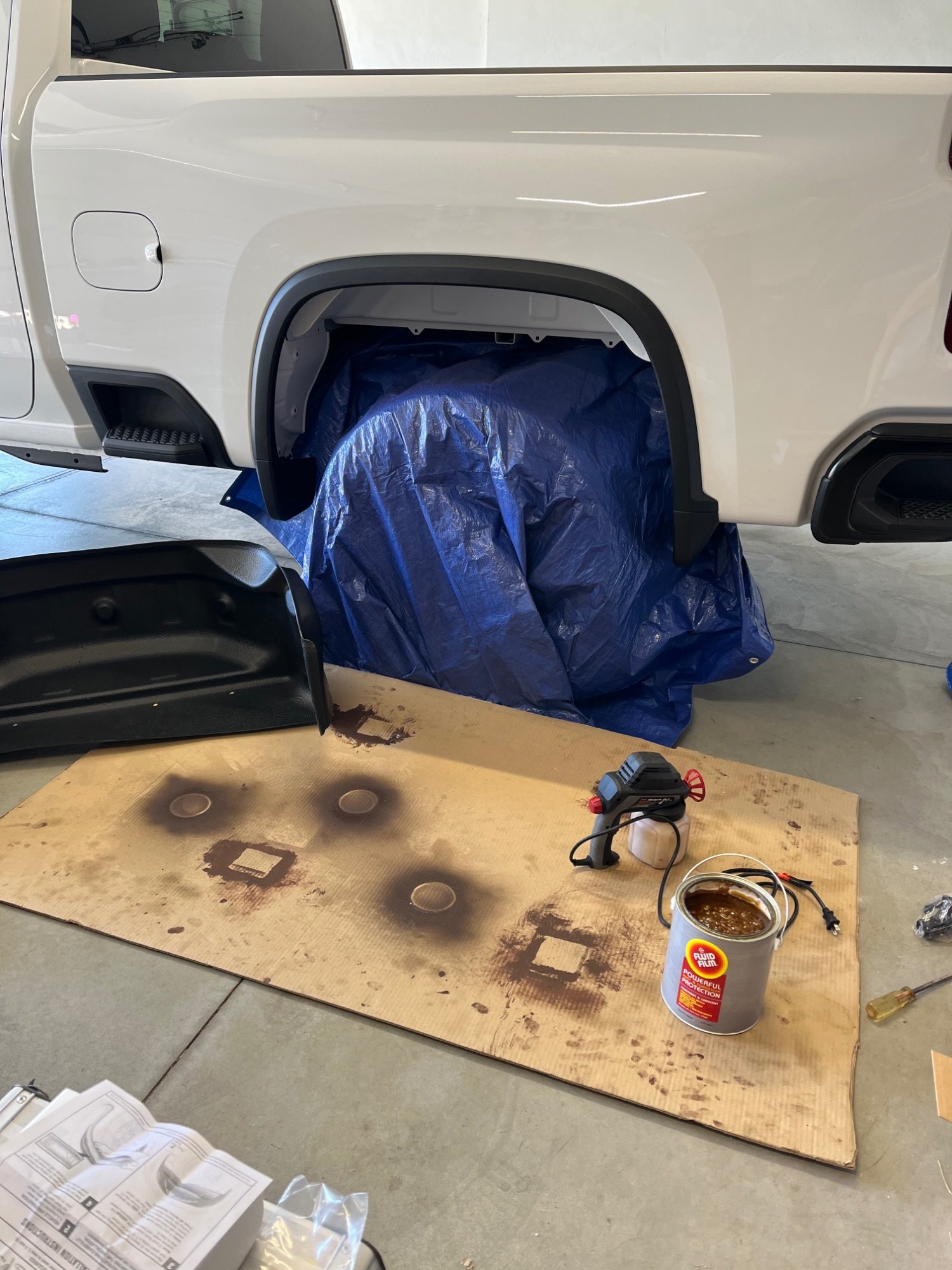

I sprayed fluid film all up into the wheel wells(not on the frame) before installing the liners. That should provide a bit more peace of mind as I’ve used that stuff for years with good success. I read you can’t use it on GM wax so I’ll do everything else before winter.

The steps look really good, sorry no help on the liners . some nice wheels and tires would really make that truck look great . my opinion some bronze wheels would look good on that white, and also match the black trim.
I’m the rare type that likes that steely look. Those tires are the A/T LTX 2 and I’ve had great luck with those in the past. These are the “upgraded” 18” steels not the base 17” ones. I will probably go up a size in tire when these wear out though

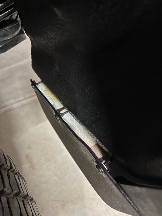

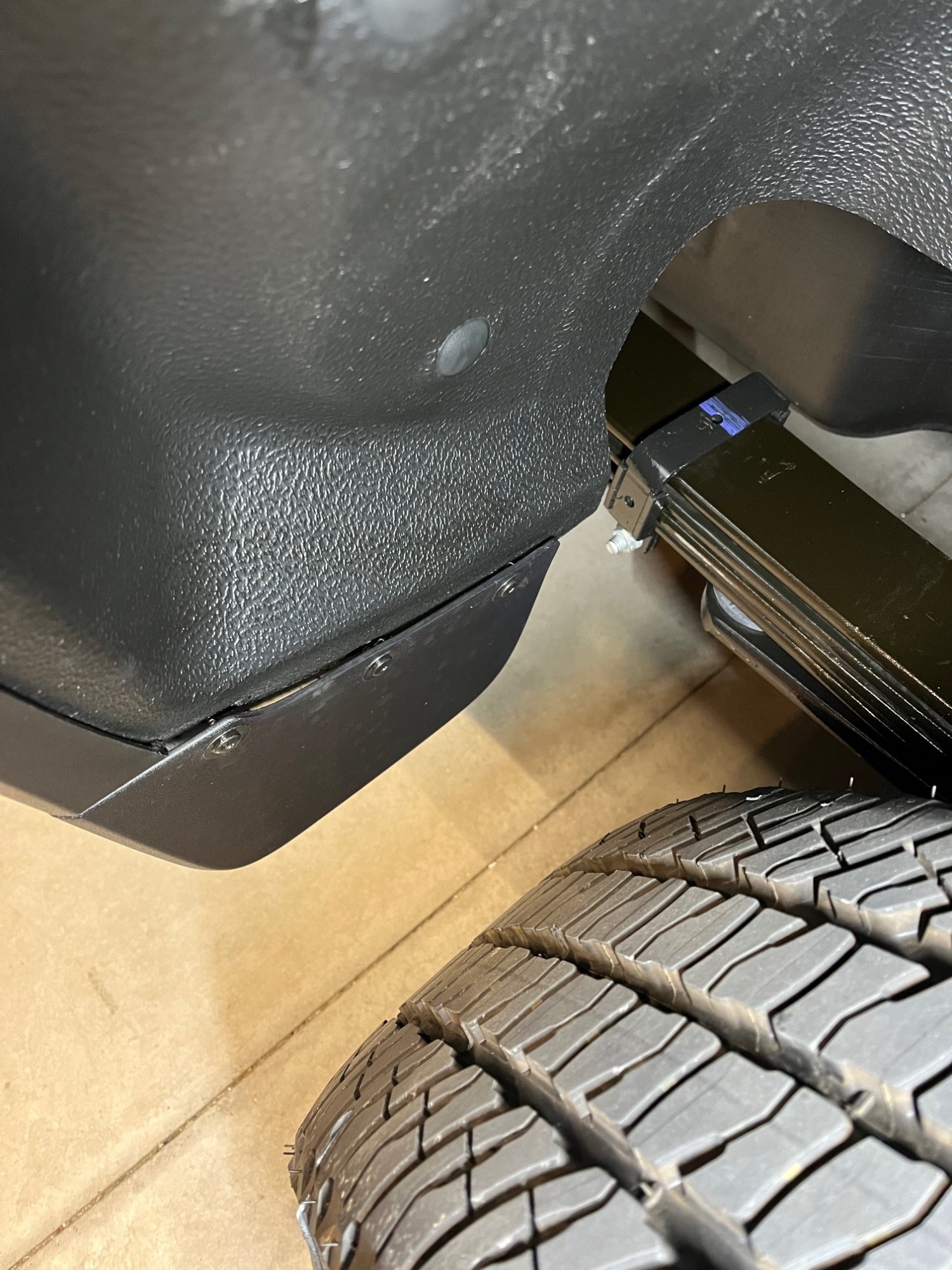

They already have holes drilled in the liners. I actually called husky and they sent out new liners due to the drivers side having tons of gaps. The new one they sent was way better and filled in the bottoms a lot better. I’ll attach a pic.
the passenger side was even tighter and a pita to get in there. This tells me the husky liners get cut by hand and with poor quality control and attention to detail.
the passenger side still has the gap. It has to do with the shape of the liner at the bottom.

Yeah those little I shaped clips with a threaded capture nut on one side are on the stock short mudflaps but those won’t hold onto the wheel well liners too. The new liners are fine and I sprayed some fluid film black down in the crack so you can’t even notice anymore.
after seeing how much coverage these husky’s provide vs the factory rear wheel well liners, I will just stick with these. They cover the whole frame rail where as the factory ones stop well short of covering the frame rail.
