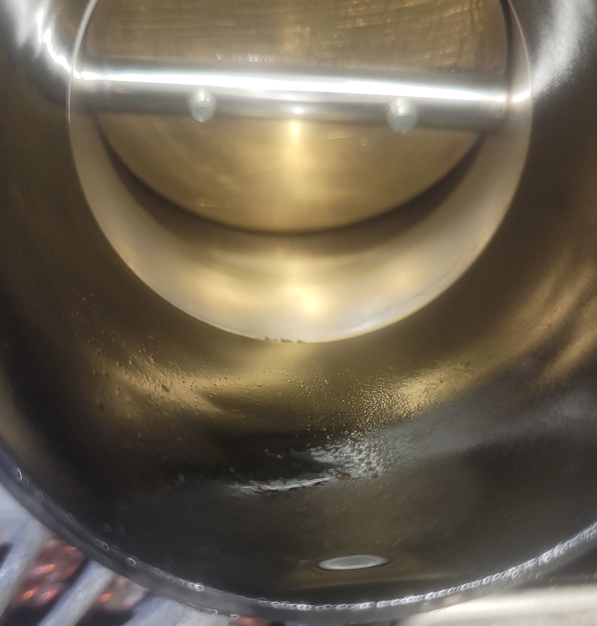

and this is what the throttle body looks like,it is also coated in oil. i guess i am going to have to develop a catch to try and stop the oil getting in to the engine for now until i can figure out how to solve this problem. there is not much info on how this pvc system works. the funny thing is i let the dealership do the last 2 oil changes and it didn't use any oil. i did  the last oil change at 40% on olm and right now it is at 60% and no oil on the dipstick. this problem has been brewing for awhile as i have had oil leaking out of the turbo outlet pipe which the dealer said was normal. now what ever is causing this is got much worse, might be because of colder weather but this is still not normal and of course i am out of warranty now
Did you write that the oil smells like fuel?  If so change it more often or go to a different oil to get a better ring and valve guide seal.
