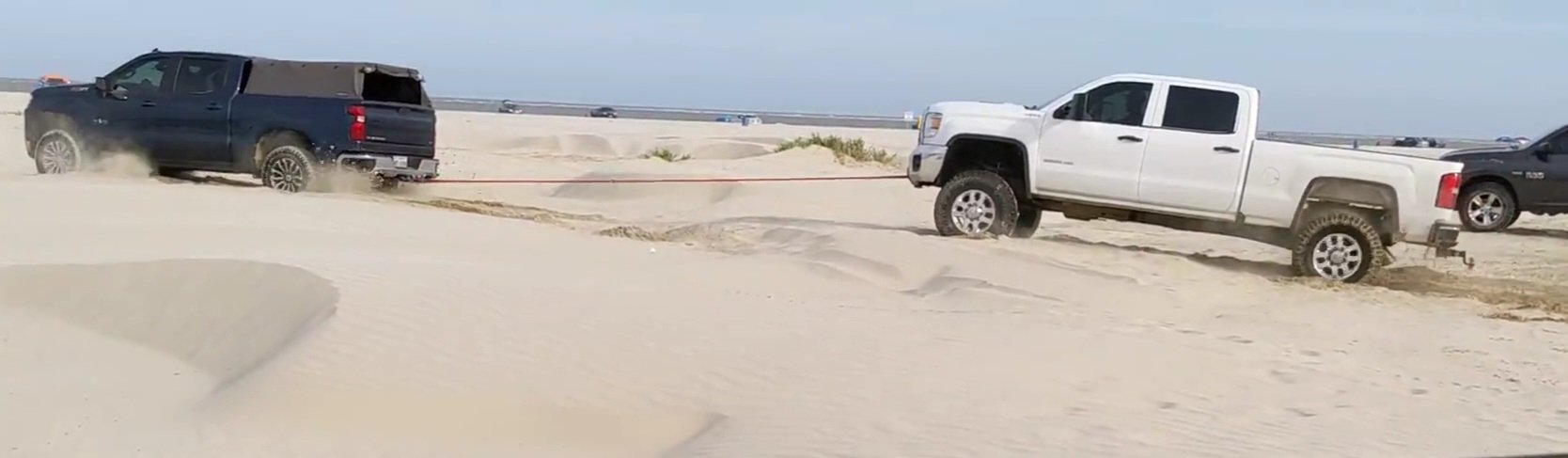

23 hours ago, It's Tim said:
I did a recovery of a 2500 Silverado this past weekend at the beach that looked very similar to this mall crawler.  A kid was driving it where he shouldn't have been and busted a CV rendering it a 2WD.  Hauled his heavy 2500 butt a quarter-mile to the beach access point....the DuraTracs got the job done.
