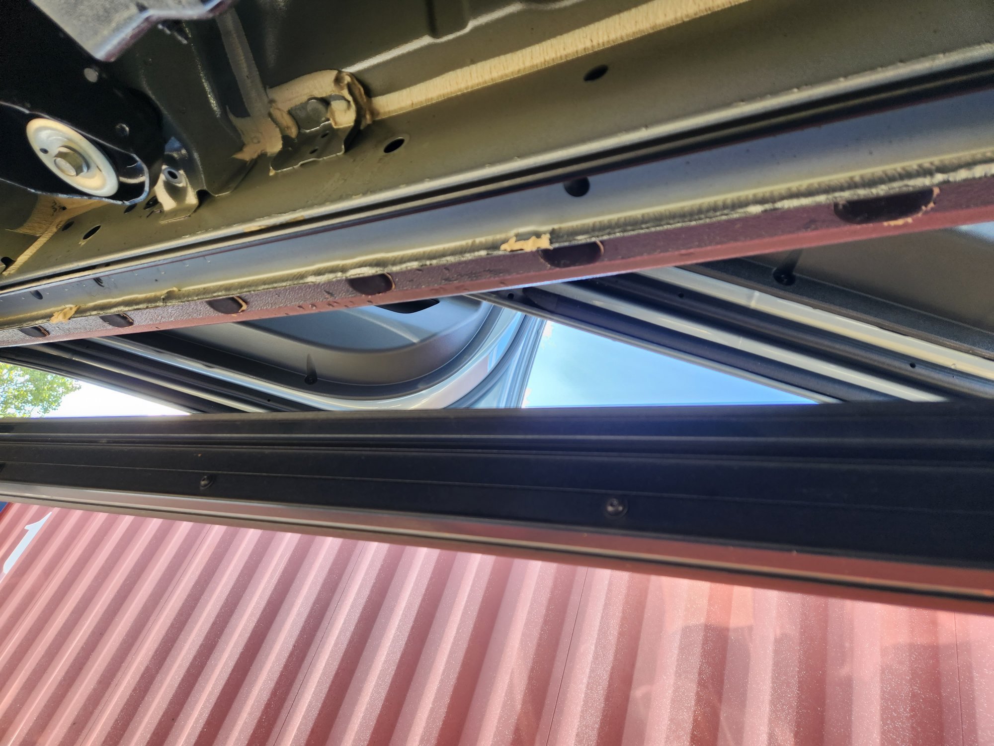

Well... Solutions are out there. My '24 HD Denali package came with the motorized running  boards. I wanted to delete them, as another thing to break.  Nope, could not delete it out of the "Denali Pkg.".  After delivery, and I rust proofed the rocker and doors with WoolWax, I got to see how well these running boards are now mounted to the rockers (compared to my '03 Tahoe , where the weld nuts pulled out of the poorly re-inforced sheetmetal).
The motorized rocker boards I now like, as they #1, do tuck up out of the way, # 2, do extend down well, for my bad knees. Aftermarket ones are available, but I saw the GM ones I have are quite stout, compared to my '03 Tahoe.
Attached pic also shows additional holes with Weld Nuts, for stationary running boards.
I just helped my friend cut off his rocker mounted steps off his '16 F-150, as the rockers were a rust failure.
That said......., spray any Lanolin Based Rust proofing in all access holes in your rockers and doors.
Check out a few on a dealer lot to see how there are now mounted.
Attached pic, shows I was rustproofing the rockers, put plumber's putty in to hold the Woolwax in for a while. Shows the running board in down position. However this only pic does not show how strong the rocker mounting is. Truck is on a 4 post lift, next to a storage container in red. Passenger and rear door open.
GMC_PLUMBERS PUTTY I PUTIN WEEP HOLES HOLDS TO CONTAIN WOOLWAX CREEP & CRAWL.jpg
