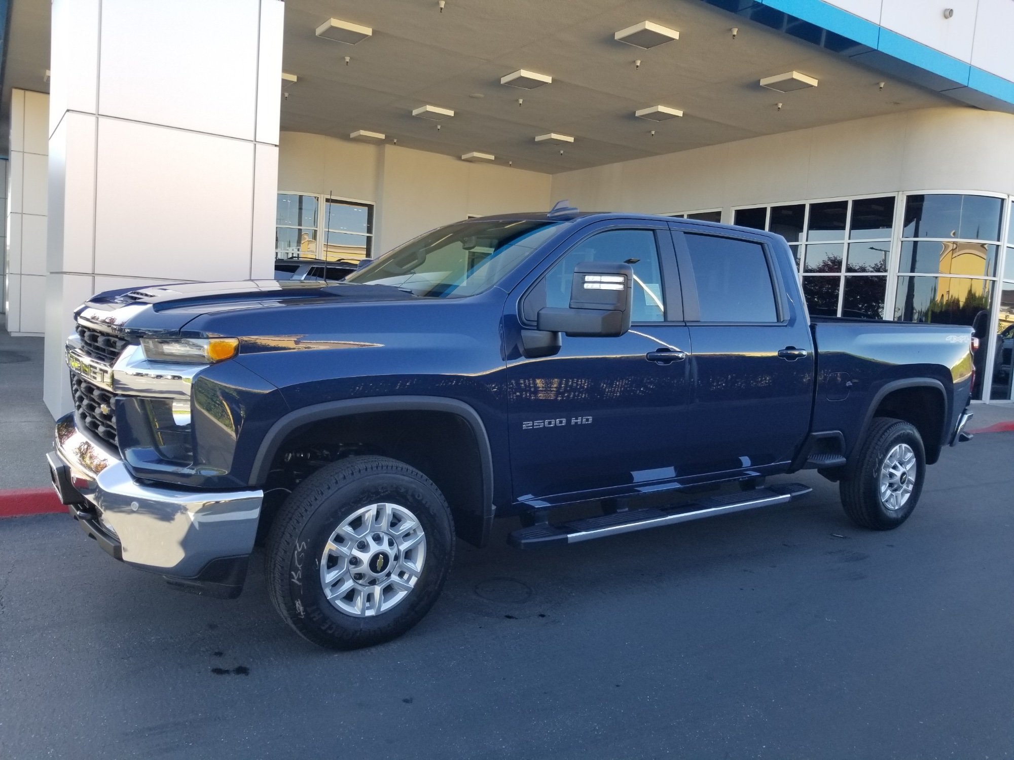

I picked up a set of lightly used 275/65r20 wheels off a 2021 denali for my 2500 I just picked up Saturday. I have the gas/6 speed and I’m wondering if there are any calibrations that I may need from the dealer for shift points or speedo. Wasn’t sure how speed was determined on these new trucks given they have gps I figure they may be able to self calibrate. I know the sizes aren’t too different and the ones I’m putting in are a stock size but I picked up my truck in transit so I was able to get it in 8 days compared to 8 months.
haven’t even hit 100mi but it’s definitely an adjustment from my 2019 5.3L. Can’t wait to pull my trailer lol.
