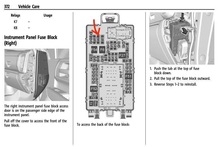

Same issue with my 2022 Trail Boss as well. Auto stop quit working first then front collision alert/adaptive cruise/lane assist. Have service appt on Monday. Pulling fuse resolved issue temporarily?

Yes. Pulling the fuse will solve it temporarily.

This is my theory on this issue. The fuse box is out of its tolerance specs, so the fuse is loose. I took the fuse and slightly bent the spades just enough to keep the fuse tight in the box. I've not had an issue at all since doing that. I also just got back from a small strip out of town and didn't have an issue. So, I might be onto something with the tolerances being off within the fuse box itself. Time will tell!

No sir, this can't be it. It takes time for it to happen again so I can 100% guarantee, you'll have this issue again.
I think it's something with the software messing up the module...
