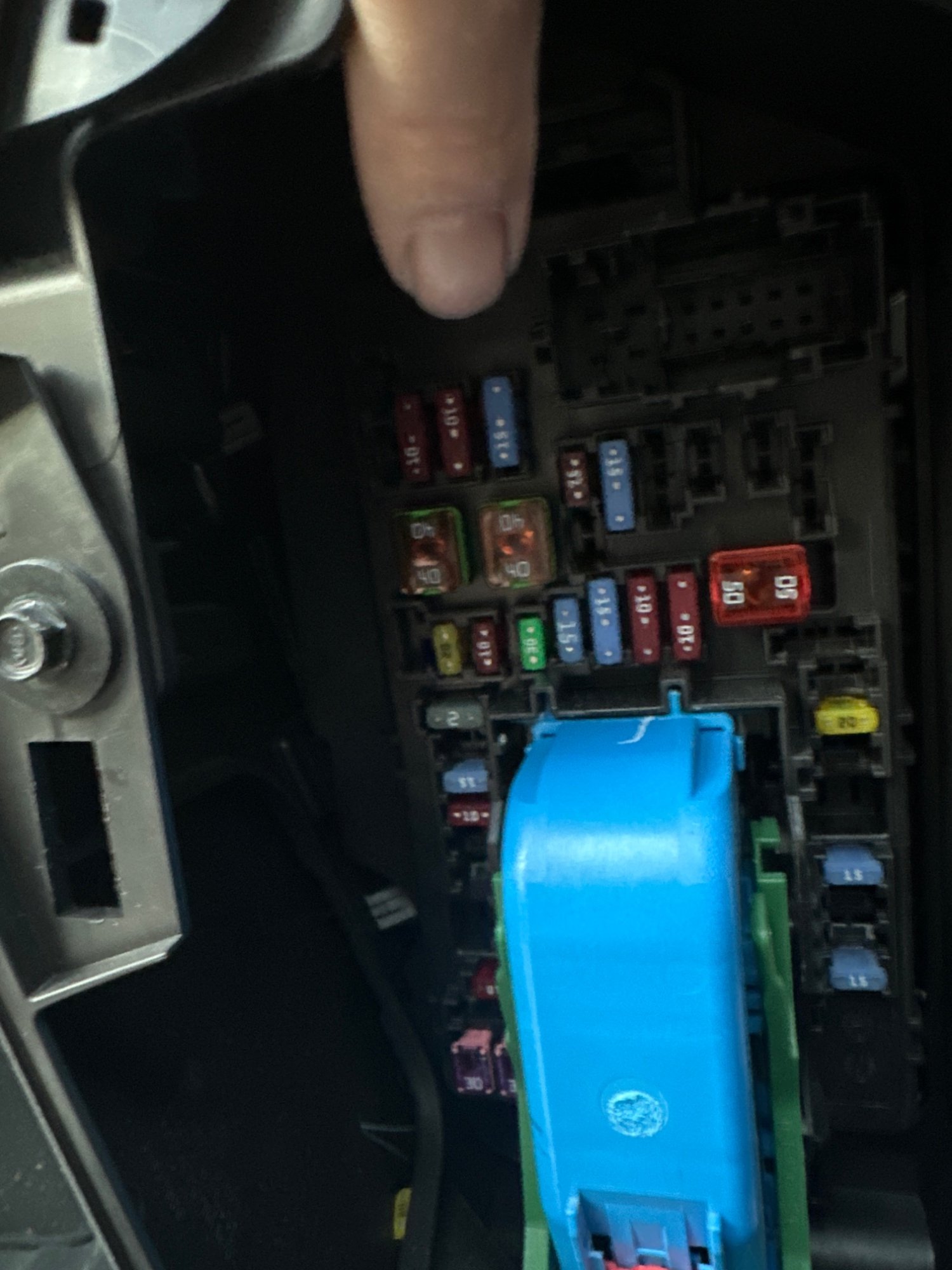

Kaylan Steen Posted February 8, 2023 Share Posted February 8, 2023 That's not how a 3 spade fuse works. The Micro 3 Fuse is designed to protect 2 different output circuits from a single power source. Power flows into the fuse via the middle prong and out via the 2 outside prongs. Only the middle spade is the power source, so you should only see voltage on the middle. A fuse is only as good as the system in which it is used. One aspect of the electrical system that has considerable effects on the performance of the fuse is the quality of the connection between the fuse and the cable it protects. If you don't have continuity between the power supply and circuit it feeds it will not work. All you have to do is test the middle spade. The only true test is the readings at the end of the circuit which would be at the ecm. The ecm is what controls work properly. Hope I explained that well! Quote Link to comment Share on other sites More sharing options...

Matt soflo Posted March 25, 2023 Share Posted March 25, 2023 I’m a gm certified paint tech working at a Chevrolet dealer and got lucky and scored a 22 rst 4 door 1500 rst duramax fresh of the 18 wheeler for cost thanks to my general manager. Same problem so I got on the gm computer system at work and printed out the instructions to fix. Pull Right side fuse panel on dash top row from left to right 10 amp fuse pull it count to 10 install and problem is fixed f11 Quote Link to comment Share on other sites More sharing options...

Kaylan Steen Posted July 25, 2023 Share Posted July 25, 2023 It's the F10 fuse that isn't making good contact. Tweak the spades just a tiny bit, wait 10 min, and reinstall. That's what fixed mine permanently. When temps change, the fuse will not make good contact, so doing a slight twist will help to keep it tight. Quote Link to comment Share on other sites More sharing options...

Hooooves Posted August 14, 2023 Share Posted August 14, 2023 On 7/25/2023 at 12:57 PM, Kaylan Steen said: It's the F10 fuse that isn't making good contact. Tweak the spades just a tiny bit, wait 10 min, and reinstall. That's what fixed mine permanently. When temps change, the fuse will not make good contact, so doing a slight twist will help to keep it tight. FWD collision alert light appeared a cpl months ago. All other systems working normal. Just noticed yesterday that the cruise control system won’t work while the FWD collision is having issues. Tried everything…. Pulled fuse 10 Pulled fuse 11 Bent the forks Disconnected battery for 10 mins. Anyone have any other ideas or is a dealer visit needed? : ( Quote Link to comment Share on other sites More sharing options...
Kaylan Steen Posted August 14, 2023 Share Posted August 14, 2023 You'll need to reset the ecm. Remove the negative terminal from Your battery. You will need to use a socket wrench to do this. Next, flip Your headlights on. This will fully drain the computer, or ECM. Wait for around 10 to 15 minutes. Then, turn the headlights off, and reconnect the negative terminal to Your battery. Start Your engine, and the computer should be reset. You may have a faulty fuse too. Sometimes, they won't look tripped, or damaged in any way. You can also add a little electrical grease to it as well. Quote Link to comment Share on other sites More sharing options...
