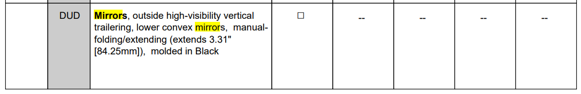

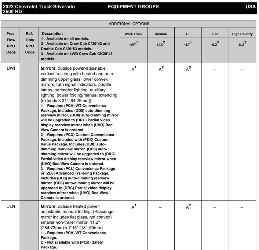

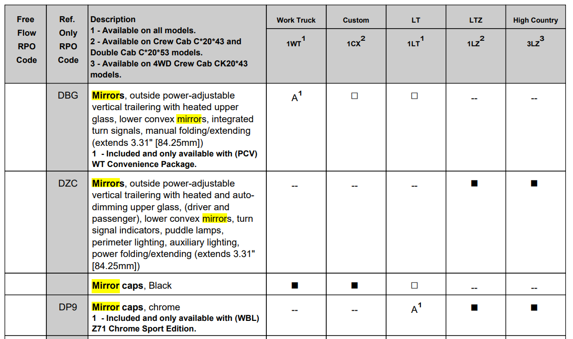

This is from the equipment group book for the 2500HD
Normal Mirrors: DWI / DLN
Trailer Mirrors are: DBG / DZC / DUD
mandrewbot3k,
Thanks for the response and effort to obtain the couple pages you attached. Looks like I have the DLN code mirrors. As to your offer of the slide over mirrors, I will continue my search here and if unsuccessful, may very well give you a shout (although I am in need fairly soon as we will be heading down to Denver in June).
