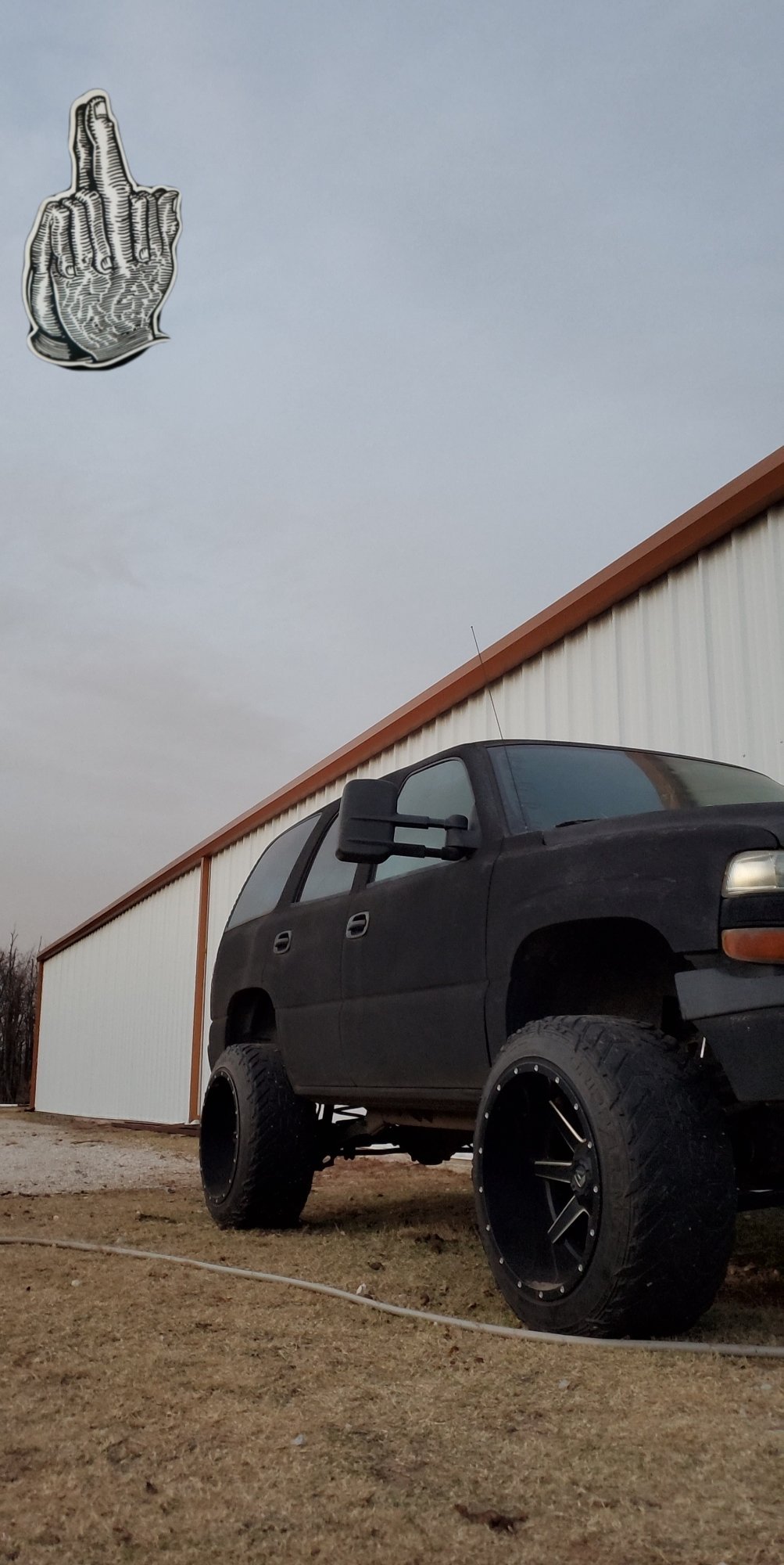

A friend gave me a 2011 2500 HD farm truck with a bad transmission. I've got a 2004 Chevy Tahoe with a 4.8 in it now. My question is. Am I able to swap motors? 2004 Chevy Snapchat-1643707673.thumb.jpg.45d2a3690af7dc10bea03d8f66b4e5fb.jpg4.8 swap to a 2011 Chevy 6.0
Could you, yes but it's not a direct swap.
2004 is a GEN 3 engine and 2011 is a GEN 4 engine. There is a ton different between the two.
Crank/cam triggers are different, the cam sensor is in a different spot. That 6.0 has VVT so it would need to be deleted with a non VVT camshaft and different cam cover/parts. The knock sensors are in a different spot and a few other things are different between the two.
