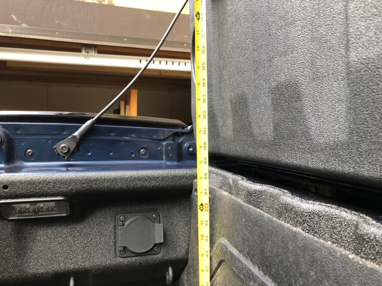

Seems like maybe you’ve answered your own questions, but I have my camper off my 2021 3500 hd srw right now and could take bed measurements if you’d like. I have the factory sprayed-in bedliner.
This picture was taken with the end of the tape measure against the front wall of the bed at the floor. The top rail of the front wall extends rearward into the bed 2 inches. So your bumpers are against the lower front wall and the rail is 2 inches closer to the front wall of your camper. Figure accordingly. It’s 101 inches from the lower front bed wall to the end of the sheet metal behind the tail light  the tail light itself protrudes another inch.DE8E4BBD-2069-4C65-A92B-2FF1743D22F8.thumb.jpeg.c5f459e8abc10afb16f5a70dbe220059.jpeg
I’m happy to do measurements, pictures, or answer questions. It’s easy right now when the camper is out. I went through the same kinds of questions when I was trying plan an installation without the products in front of me.
