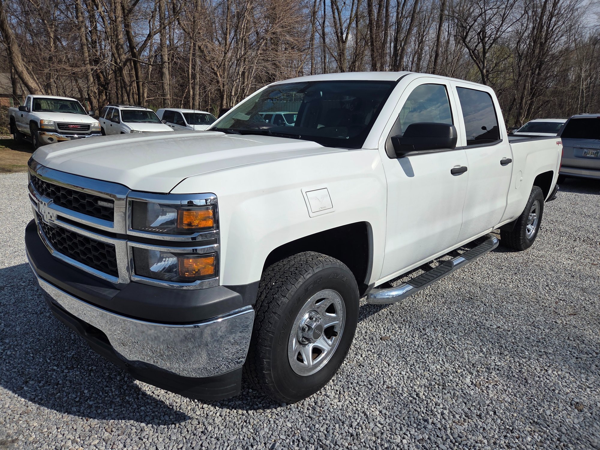

This is how I bought it. A 2014 CCSB with 17k miles on it. Leveling kit, 33" Nittos on Black Rhino wheels, and a Smittybilt bumper. Great looking truck, but the big tires aren't great for EV range and I really like the look of a lowered truck.
I installed an IHC 3/5 kit that's a flip kit and control arms. I wish I could've gone lower, but the battery pack and its housing (roll cage I guess?) sit so far down that I'm already 3.5" off the ground as it is. Here is the truck now:
