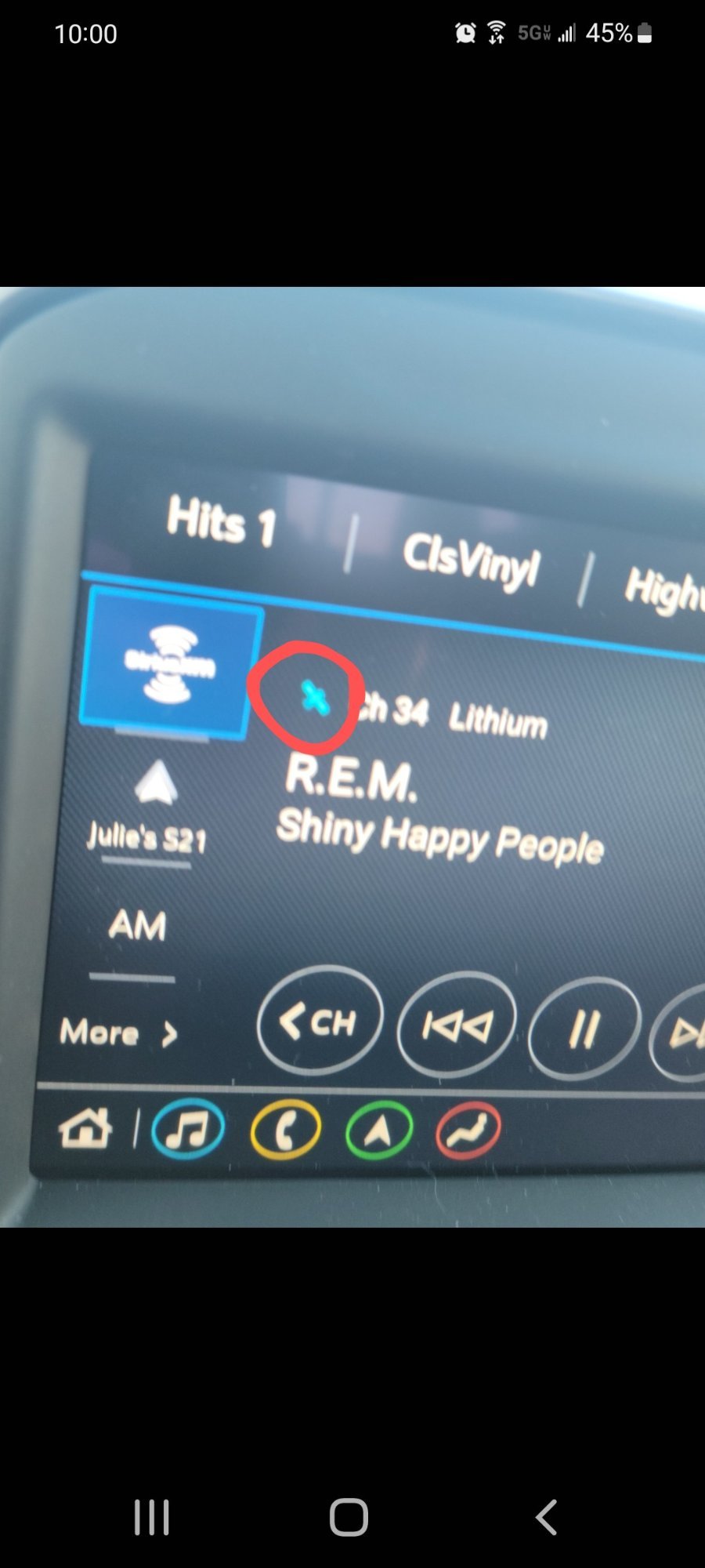

8 minutes ago, dieselfan1 said:
2022 LTD LTZ
Wife says her Phone don't connect and the radio is in airplane mode.
How do you turn this off?
Nothing in owners manual mentions airplane mode.
I'm pretty sure that is just saying it's on a satellite station. not airplane mode. It also looks like it is connected via android auto.
Yea that looks like a satellite icon for sirius XM.
And there is a phone connected to the truck it appears, says "Julie's S21" on the left side there.
Is the phone plugged in?  If its plugged in and she is trying to connect via bluetooth, it won't work because its plugged in.
