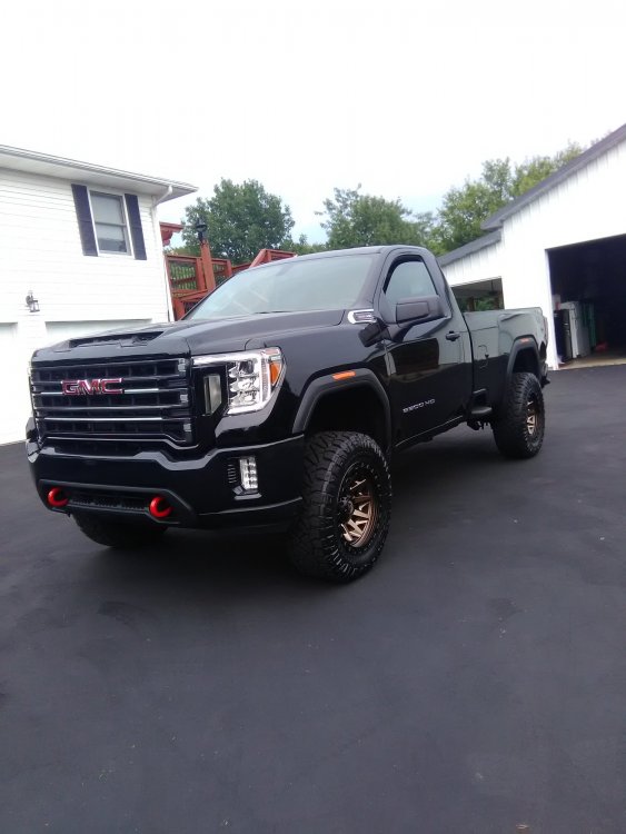

Yep it's a good kit , I combined mine with suspension max 1in rear block kit instead and suspension max diff drop . I'm also running fuel covert bronze wheels 20/10 -18 bs. Excellent ride had to do minor trimming on front mud flaps but other than that very happy. May add the suspension max steering damper soon just for the heck ove it.
truck looks good, im about to order cognito 3inch performance lift that comes with the shocks and im going to order the pitman idler arm support kit also. im going put put 285/75/18 nitto ridge grapplers on my factory wheels for now because i like them and havent seen anything that has stood out to me yet but if i do i will still be staying with the 18 i like more tire than wheel. do you recommend the diff drop?
I did the diff drop more for peace of mind, I figured it couldn't hurt to keep the CV angle flat as possible. I also did the pisk you ordered just forgot to put it in my post. The truck drives excellent in my opinion, in fact better than the 19 bone stock work truck we have for reference.
Used the supplied fox 2.0 non reserve shocks on all four corners. With kit supplied front top shock mount, the only cutting you have to do on the hole kit is chop of the front service mounts located above the top a arm forward position.
whats your fender height front a rear
43 3/4 front 43 7/8 rear with a lot of thread left to go on the key adjustment up front, keep in mind I'm a reg cab 3500 so it may end up a little different on a 4 door 2500 . I always like to get the rear where I want it first then adjust the front accordingly.
