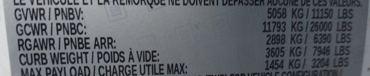

20220218_131539.thumb.jpg.fda3030306fcf3e2262775bca6fd5612.jpgJust looking for a 2nd opinion.
Curb weight is 7946lb (3645kg) not sure which size of jack stands to get. 3.5T, 4T or 5T? Currently the truck is stock, but I'll be adding things to it in the future ( eg: plow, lift, etc.)

Is it a gas engine or a duramax?
It would have to be a fully loaded with every option long bed truck to weigh that much for a 2500 truck.
With that said you should get 3.5 Ton at a minimum just to play it safe. The front is going to weigh more than the rear because of the engine but the stands will never be supporting the full weight of the vehicle. I use 2 Ton stands for half ton trucks.
Edited by CamGTP
CamGTP, My curb weight on my short box 2500 is 8,372 lbs.  With that said, I agree that you should have 3.5 ton if not higher capacity jack stands as a good portion of stands are rated in pairs similar to ramps.  I have never met anyone that complained that they had too much jack stand capacity.  Those with too little may not be around to tell the story.
