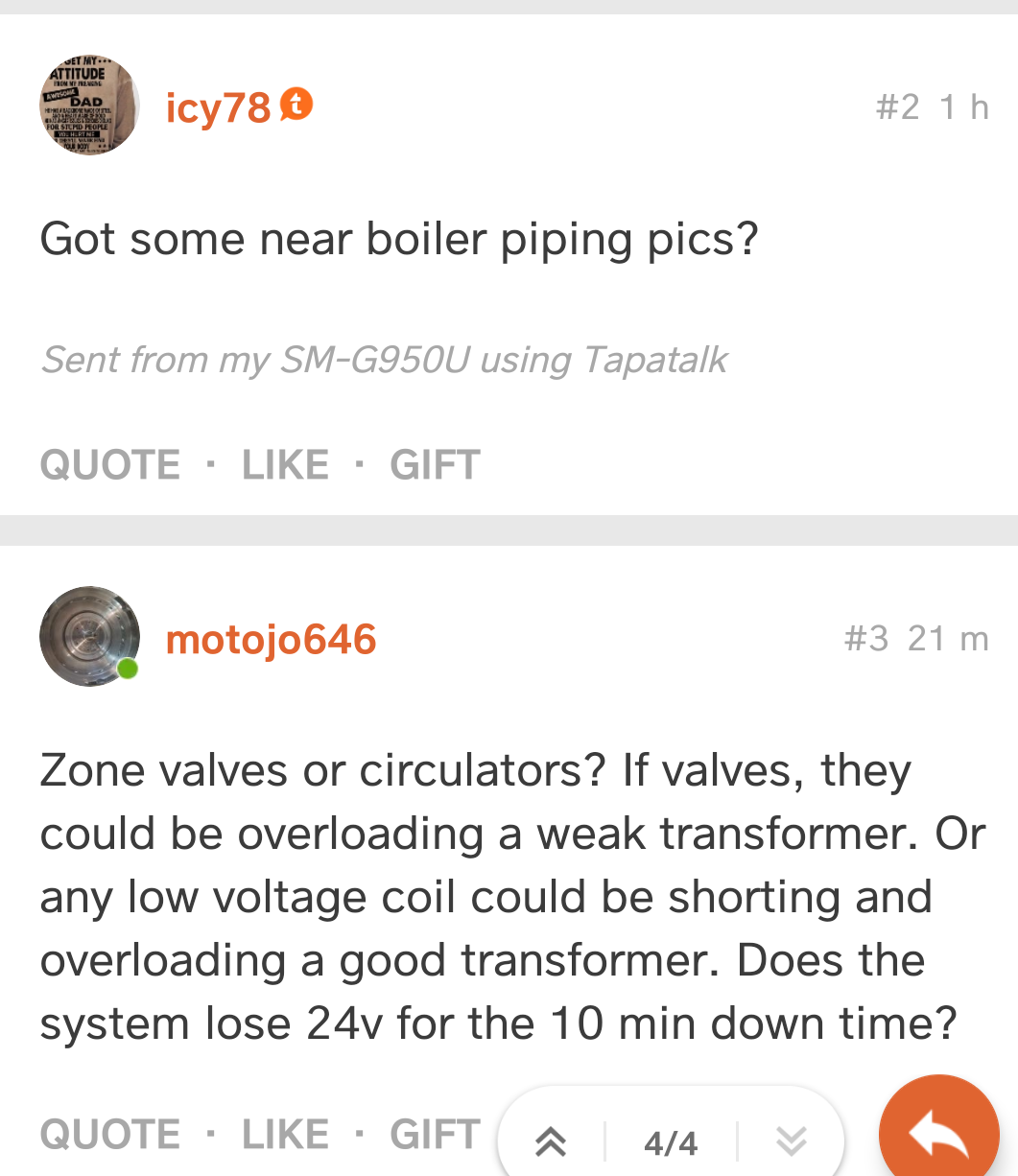

Ok so I reached out to some guys on a pro forum that is no diy. Here are some questions they have. If you want to trouble shoot this I am more then willing to go back and fourth.
However I have to remove myself from any liability.
My guys know there stuff, so be prepared for some questions.
If you do not mind can you answer any questions and provide pictures as needed.
