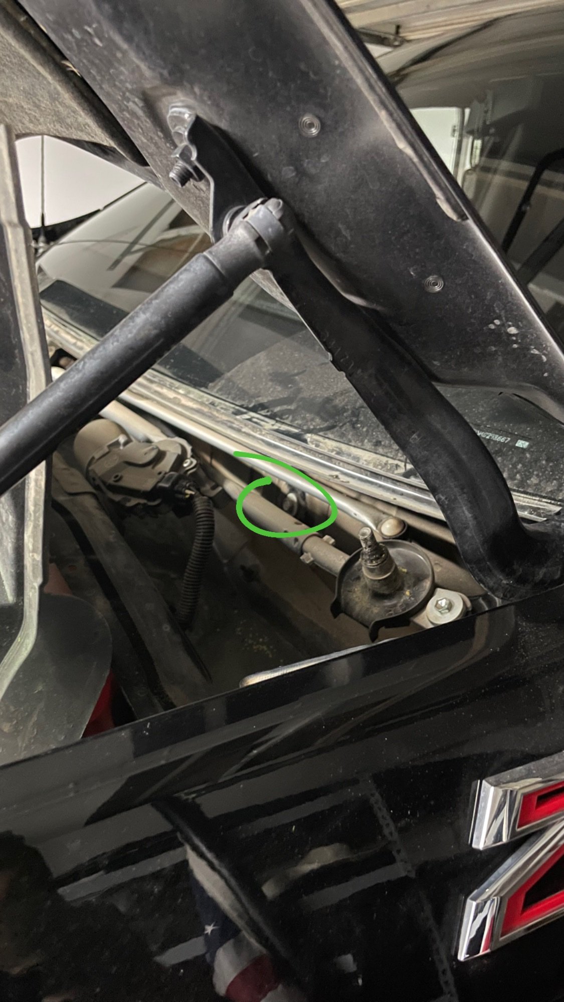

Been chasing a very pronounced dash rattle directly behind the cluster  for months. Almost Removed the entire dash and no luck. The interweb didn’t help much, never seen this before.
just earlier I removed the windshield wipers and plastic cover and found a really loose bolt. Under the wiper motor. Not tight at all. Had to use the impact because it kept spinning I assume there’s a nut on the other side. Now it’s tight. My cabin is now RATTLE FREE. 2019 CC z71 58k miles.

Good job finding it.  Rattles/creaks/squeaks are the worst.
In case somebody searches "rattle", I had one that drove me nuts.  Thought it was the dash and so did the dealer, so they took it damn near apart.  You could hear it better but it wasn't in the dash.  It ended up being a wiring harness rubbing on the transmission bell housing.  10 minute fix.  I understand after they found it, it went upstream to GM and they changed the manufacturing process so it wouldn't happen to others.  Who knows if that happened though.
Edited by cltsig
Absolutely it’s always great to post these finds for the next person. This rattle almost  made want to trade this in lol. Thats how bad it was. Other then my 8speed reverse clunk hoping warranty fixes it. I would say having a permanent rattle that cannot he found is worse.  I took apart almost everything and zip tied this and taped that etc. went underneath the dash taped a lot of wires etcc…. I even thought it was shocks. Rattles are evil and serve no purpose.
Edited by 11bravoZ71
